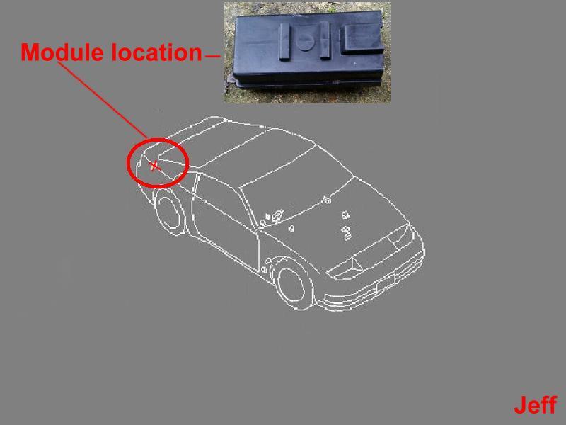

Ok sorry I did not chip in earlier was sort of hoping the quick and easy answer would come but seems not, so the lights alert system is very, very simple and is carried out by a small relay box that some will know about that is in the loom by the rear light on the drivers side.
The easiest way to stop the warning with the lights that are fitted is to eliminate the circuit through the lights out module, so basically link it out, side lights in and side lights out link and the same with brake lights in and out link, remove the power from the unit and all done no more lights out when braking and no need for load resisters etc.
I will find the wiring diagram and post it later with the link out colours.
