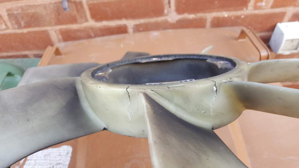

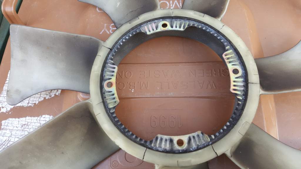

I'm after a good condition fan, as mine has some small cracks in it. It's just the fan blades I need and not the viscous part.
I'd advise a new part, it will be hard to find a good used fan blade and if you do, it likely won't last long before cracking again.
Seconded!
Don't waste your time with a used fan - false economy as you'll never find one good enough anyway.

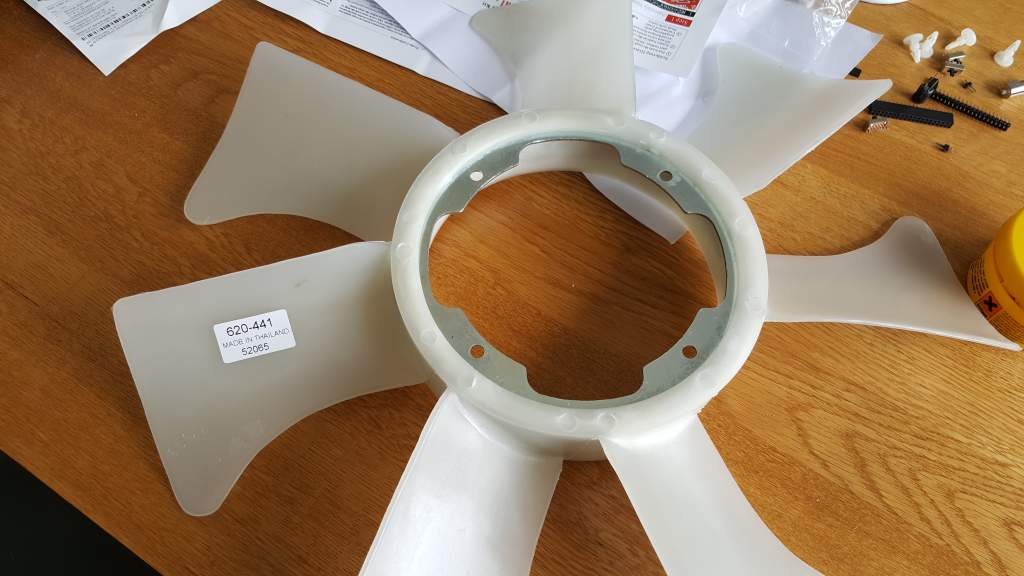

Thanks for all of the help from everyone! I must admit, I was looking at other Nissans for fans that might fit.

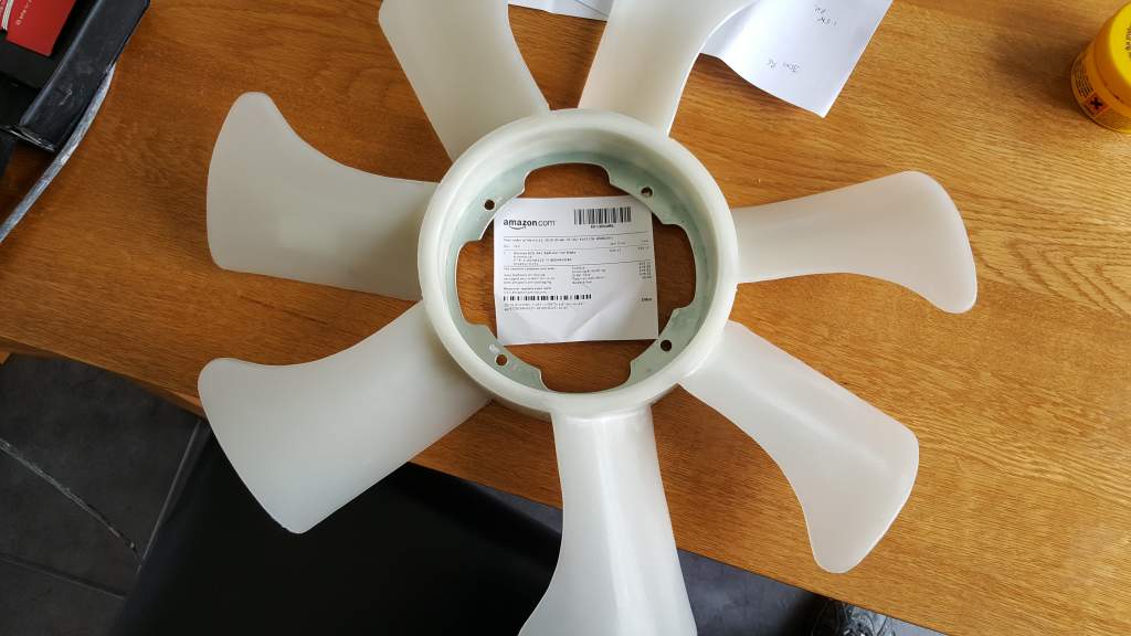

In the end, I used the part number above (620-441). I put it in Amazon and I've found one for £56 delivered from America, including import duty. Bargain, if it turns up.
I just thought I'd finish the thread off. My new fan arrived a week after I ordered it and I finally got chance to fit it yesterday. It fitted fine and seems identical to the original, without the cracks!20160405_150021.jpg
