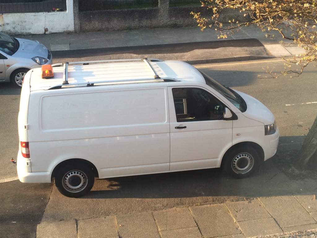

Me & my dad bought a new project this week, a 2010 vw transporter. It's just a panel van at the moment but we've got plans to turn it into a camper/day van. So jobs are to put windows in it, electrics, insulation & carpet it all out. Then decide how far we wana go with it. Might just put a bed in it or go for units, sink, cupboards etc. Needs a few mods to the exterior as well. Got it for a bargain price.

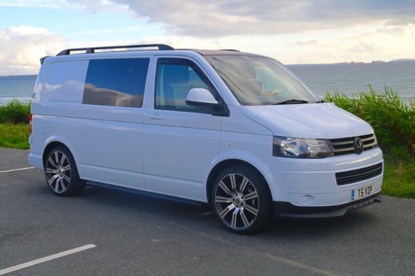

Cheers Gaz. I love it already, great little van. Hopefully it'll end up like this.
The t5 is a great van which carries mods very nicely. Good luck with it mate I'm jealous!!

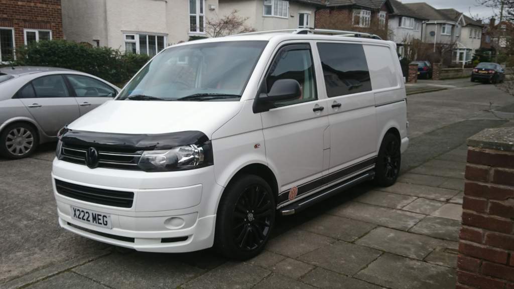

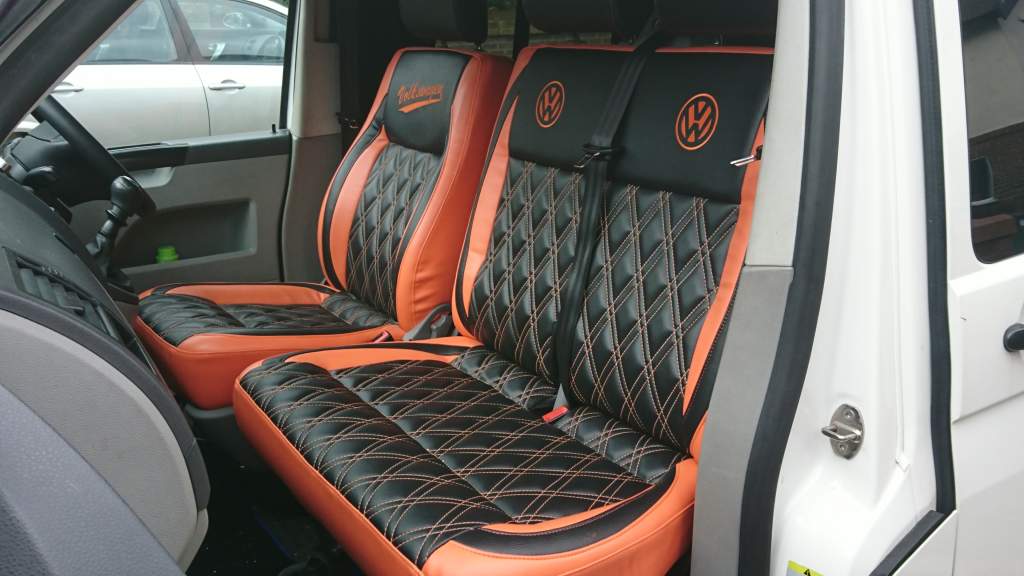

We've been working on Meg over the winter. Glass in the sides & back, curtains, leisure battery, led lights, Insulated & carpeted walls, new seats, full width rock & roll bed. & I've just fitted 20" range rover alloys. She's now ready for camping this summer, just bought an awning to fit on the side to give us more space. Just hope we get the weather now. I went with a bold orange theme for the seats but think it works well on these vans. Not too fussed on the rear seats so might ask mondo to design something new for next year but they'll do for now.

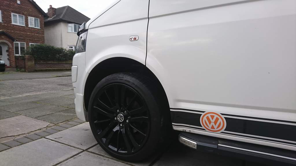

wow...i never knew the range rover had the same fitment for the wheels Tom..looks totally fab mate:yes:
Yes mate. Just needed spigot rings, 5mm spacers & some range rover to Vw wheel nuts. Bentley wheels fit as well but they're expensive. I'll give you a vw wave if I go past you in it :-)
