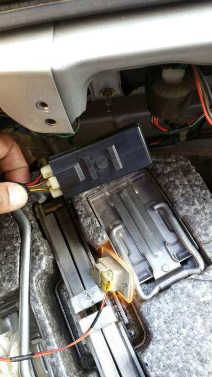

There is a little black box behind the rear drivers side light plastic panel, this is the side light sensor/ controller and likely water ingress on the board causing a short or bad connection
Thanks. I'll check that next
Sent from my VG30DETT
Anyone got one I can buy/have off them? It's bone dry but run out of things to check
The board looks perfect. Nothings come loose or looks bad.

thanks for the replies, checked the bulbs and the bulb holder loom swoped both sides over and the drivers side loom and bulbs work in passenger side but still not night lights on pass side! got power going into the black box will have a look see if can track any power out, will probably stick a wanted up for the controller box see if that works.
dan.:thumbup1:
turned out to be the sensor controller luckily facebook group helped out sorted now.
