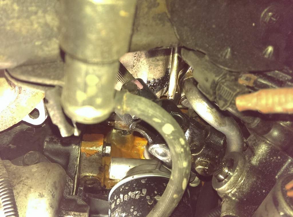

Before buying new turbos, have a look underneath the car. I've got a Zed in at the moment that was delivered to me for dyno work, despite having been smoking. White, acrid smoke. 10 seconds on the ramp was all it took to see the oil practically dripping out of the CHRA :sad:
