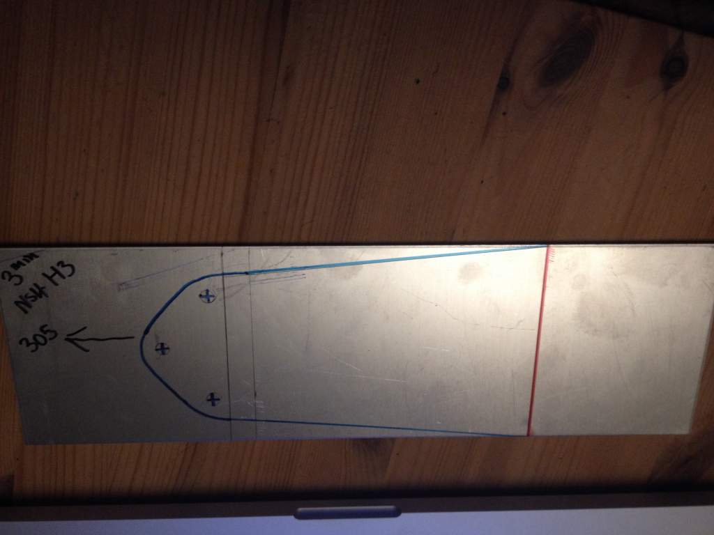

Well today gave me enough time to fit the cooler in place and mark out the mounting bracket for the remote transmission fluid filter, ready to fabricate tomorrow....... well ready today but my tools are at work... lol
Had to pack everything away when it started to hail.......

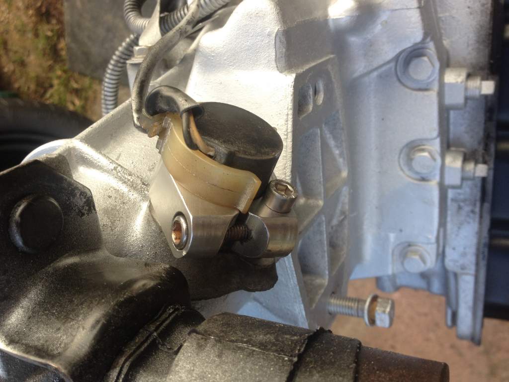

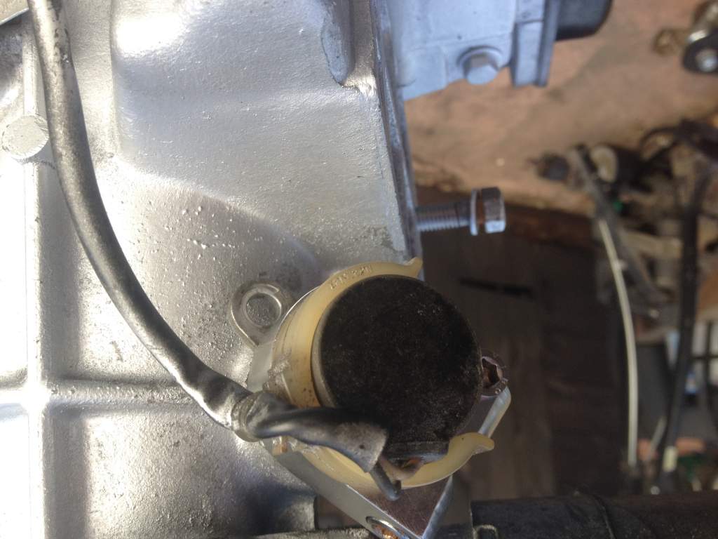

I found on a few sites you need to change the speed sensor on the TT auto box as it puts the speedo out due to my car having an NA rear diff......
I went to swap my NA sensor into the TT box and found it is too big to fit in the hole.....
Does anyone have any knowledge of this or how to proceed please???
Thank you so much for that Andrew..... I tried searching using so many different searches and found nothing..... typical....
Now at least I can Fabricate something to work.....
Russ
Well I got 30 minutes to fabricate / macgyver something to clamp the TT speed sensor about 225 degrees clockwise.
I swapped the plastic gear on the end for the bigger NA one.
I read it should be 180 degree, but turns freely upto 270 degree. At 180 it feels as if the gear isn't engaged properly, so went for how it felt rotating between 180 and tight at 270....
I used an old scooter clamp from my sons broken stunt scooter as it was perfect at 32mm ID.
I then marked the old screw hole on it and drilled a hole for an socket bolt.
nice snug fit, no movement.... Perfect...
This way I can loosen and adjust the sensor easily...
This is thanks to Andrew's help earlier today.... Thanks again!
