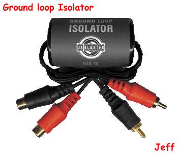

As an alternative you could try moving the earth point to any amplifiers or the crossover if it is a powered active one, also check the earth to the back of the head unit is connected, this can be missed and it then relies on the earth through the aerial which can be problematic, finally if your using phono line out fit a line suppressor after the head unit before it goes into any amps or crossovers.
