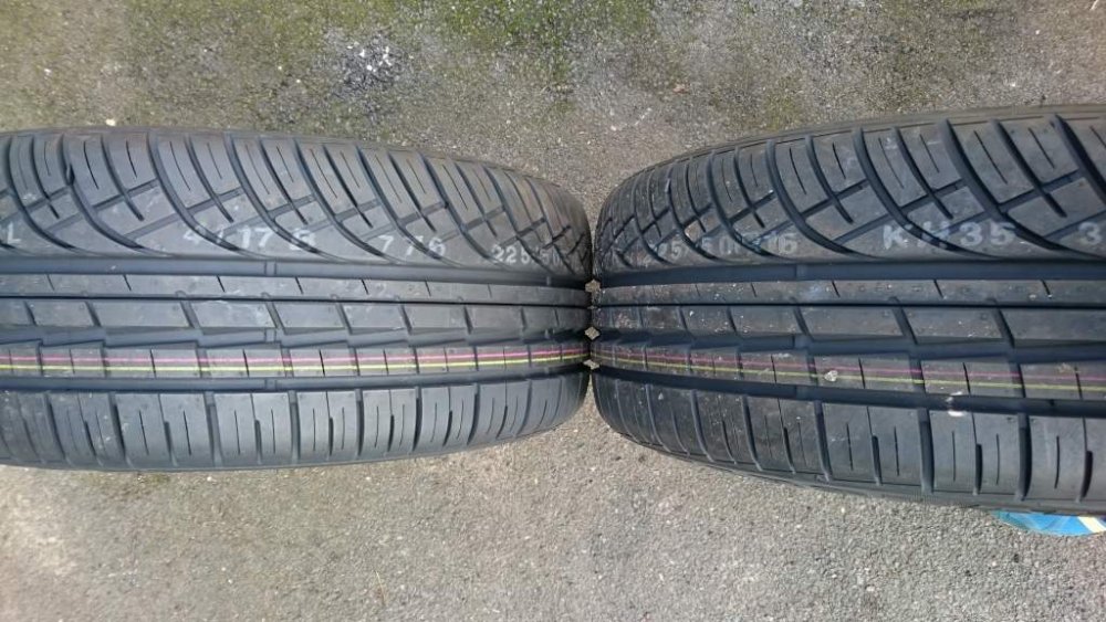

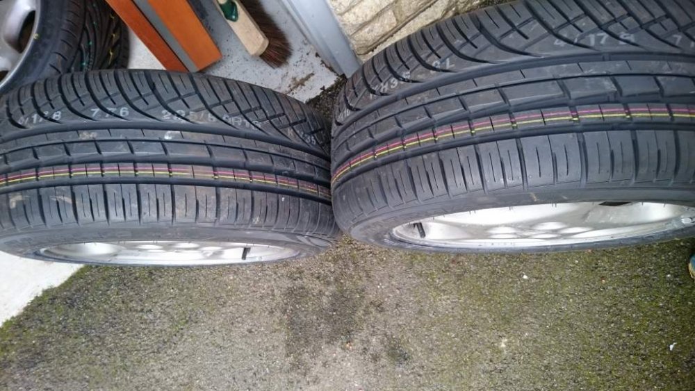

Anyways, i've attached some photos of the two front wheels. They aren't great condition as you can see, but at least they're not out of shape like my whees on there at the moment!
This first one should show you the difference in the alloy front...
The one is deeper than the other, both are meant to be fronts.
As you can see, one is slightly wider than the other.
I'm not able to get a refund on tyres, so i need another front to match the one i have. I wanted to know, as they are the same tyre but one is stratched a little more than the other, would this cause me any problems when driving?

It is difficult to see from those photos - they do look like OEM wheels. If one rim is wider then it will be a 16x8.5J rim used
on the rear wheels as I posted earlier. You will be after a 16x7.5J rim used on the fronts wheels. You should also bear in mind

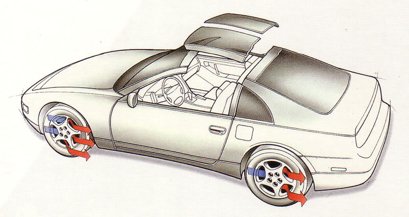

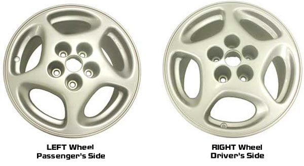

that 300ZX wheels are right and left handed to help brake cooling:

Not very clear to see in the picture, but it looks like the front one is a 8.5J rear wheel (spokes and center run/point slightly inwards) and the right one is a 7.5J front wheel (spokes/center point outwards).
So this would mean the tires are put on the wrong way around...
From the top of my head the standard (staggered) wheels are also stamped with the correct side...RR (rear right), FL (front left), etc

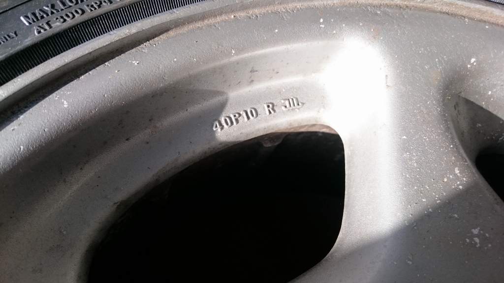

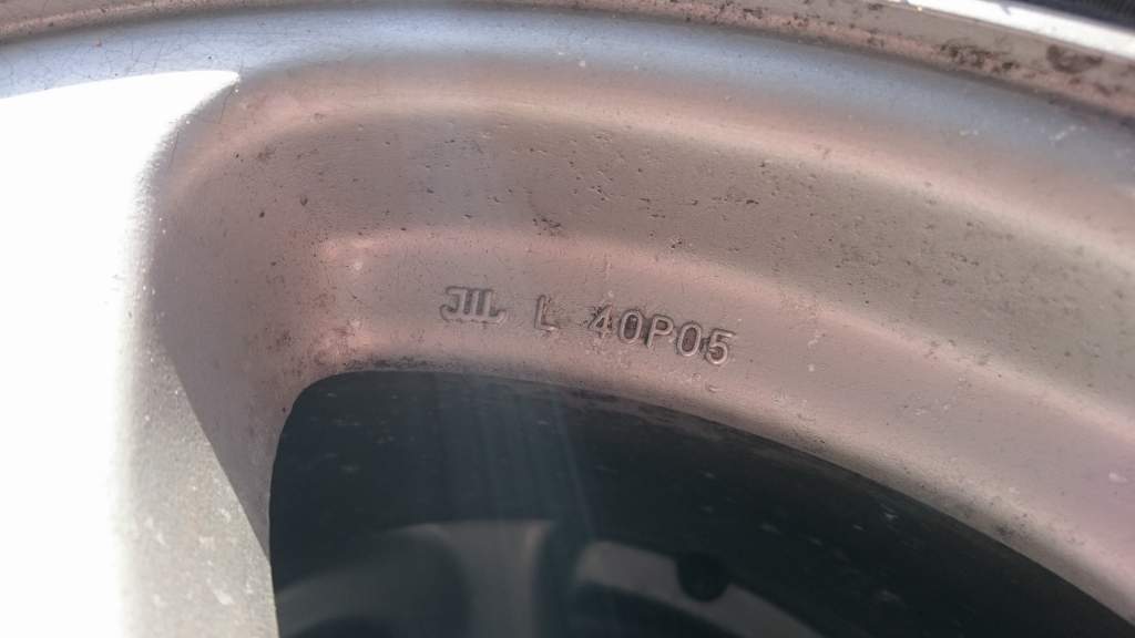

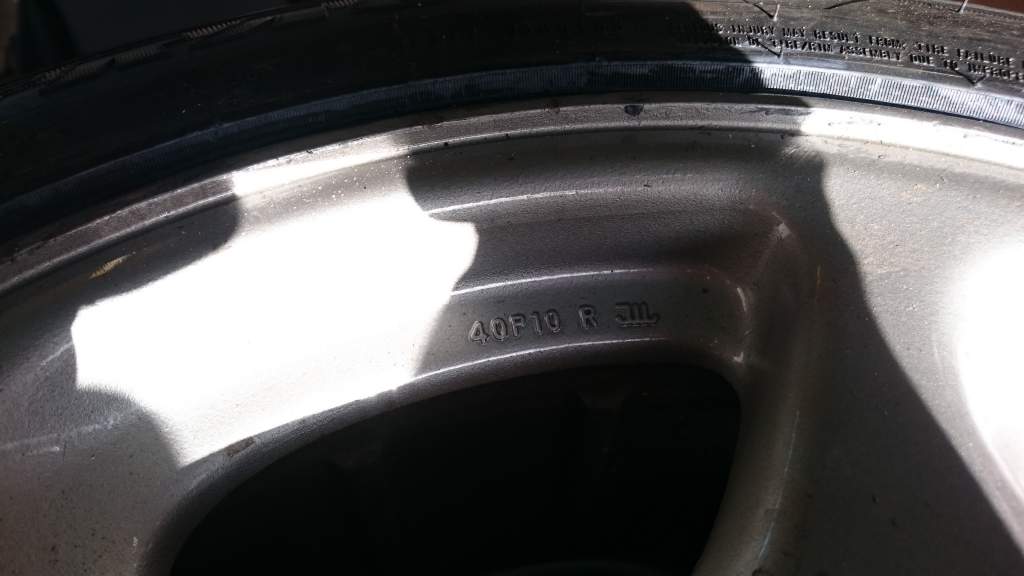

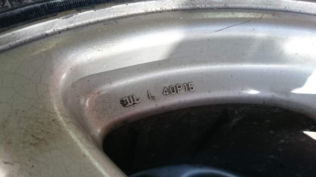

Thanks for the replies about the wheels guys, below i have attached everything i have. As you can see i have two right hand side rears and two different sizes of front wheel.
I am still battling to get these returned and a full refund, the problem is the tyres have been fitted now and he beleives the tyres were ok...they were from from ok.
Did some digging for you:
Rear Right 40300-40P10 16x8.5J
Rear Left 40300-40P15 16x8.5J
so your photos show you have two rear right wheels.
The 40P05 will be a Left Front 16x7.5J wheel. I don't know the stamping number for a Right Front as the Nissan FAST (parts
database) numbers don't correspond to the part numbers stamped on the wheel. Someone who has OEM wheels will be
able to confirm what it is (possibly 40P00).
