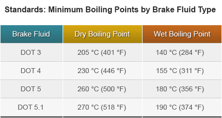

Yes you can, DOT 3 will have lower dry and wet boiling point temperatures than DOT 5.1. By mixing the two you
will drop the boiling point(s) of the whole fluid but otherwise they are compatible.
Edited by AndrewG
Added chart (Ignore DOT 5)
