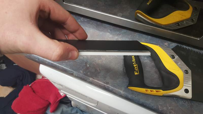

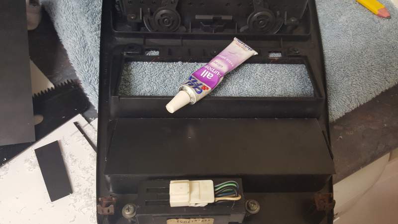

Measure the hole you are wanting to cover

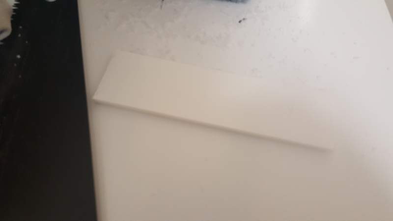

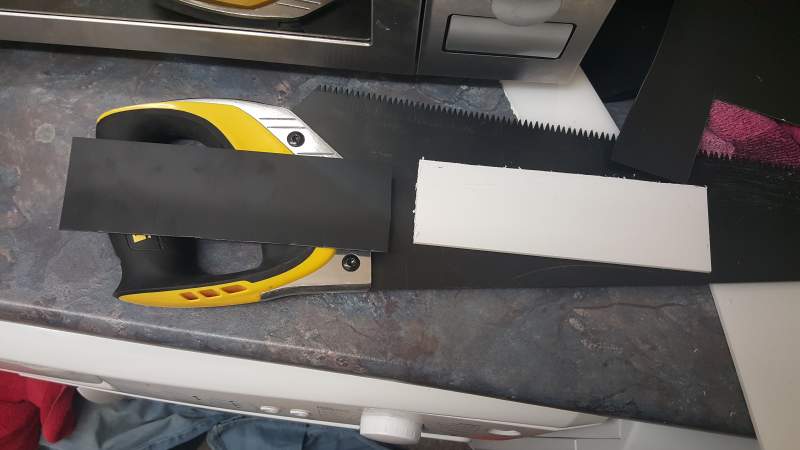

Get some 1.5-2mm of acrylic and cut out the shape
Get some thin card or anything with a colour of your choice
Glue those two together

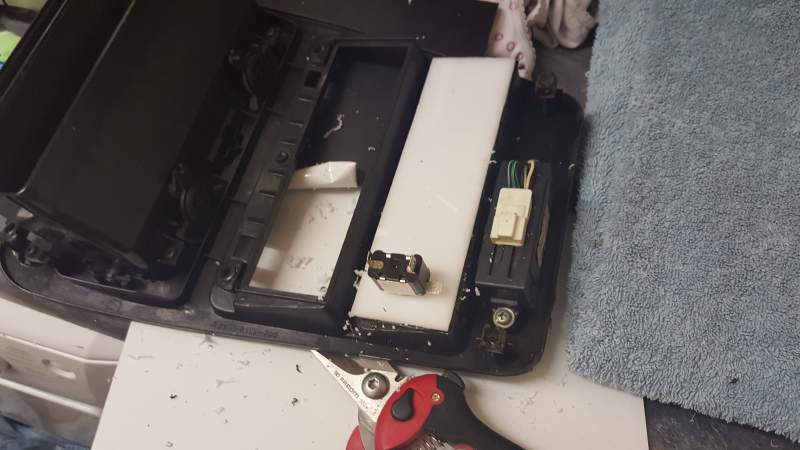

Then glue them into the preferred hole

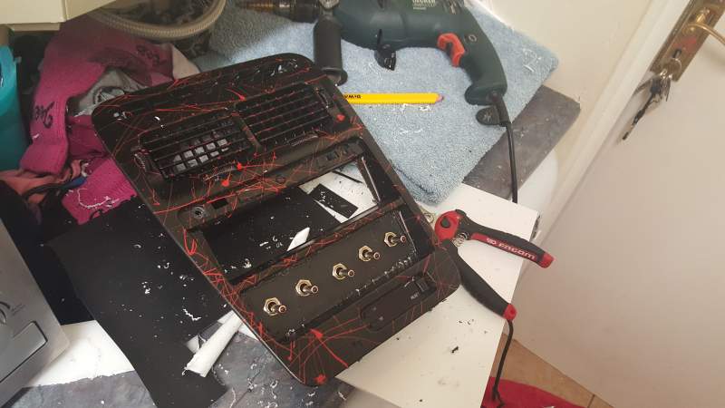

Then... once it's all dry you can start drilling into the acrylic to fit the switches
I have chosen 5 switches and tried to get them in line as much as I could. Also the tip of the switch lights up when it's on the "on" position :D
And there you go... took me about an hour and half and I am very happy with the outcome
