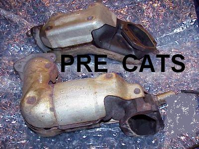

Hi has anyone got a pic of a pre-cat, I'm not sure if I have one or not? Steve
I'm told if I have one its on passenger side only, do you no which one in the pic it would be.??
I need to now what decat pipes I need for 96z
Only UK zeds had a precat on the pass side, Japs only have the normal cats two at the end of the downpipes under the gearbox
