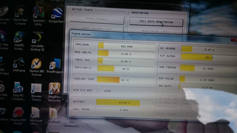

I've recently had an issue arise with my twin turbo.
I've noticed she runs a little lumpy on idle with the occasional mild misfire. I decided to get myself a free version of consult and plugged it in.
The readings I got back that I've been advised are out of place are the aac/i-acv readings are at 44% and the idle speed is dancing around the 900 rpm area. At points the engine does run lower but it seems to wander around a little when the mood takes it.
The error code on the diagnostic is also showing code 34 knock sensor. This is obviously going to play around with something if the knock sensor is dead.
I am going to cancel the knock sensor error by inserting a resistor in to the circuit and removing the knock sensor as advised by Mark, but whilst thinking about things this morning, I'm wondering if the knock sensor is OK, but it's showing the code because it's picking up the misfires? Is this a possibility?
I'm.still running a series 1 ptu and I'm fairly sure I have a dicky coil pack somewhere thats causing the misfire. Not sure when the plugs last got changed either. So do you think I should change the ptu, plugs and coil packs before I remove the knock sensor from the circuit?
Or would the code be nothing to do with misfire?
Any thoughts out there?
Here's the read out.. Ignore the temperature reading as it remained the same once it was up to running temperature.

Ok NemisizX, you have done what many zed owners do and understandably given some of the innovations the z32 had on board in 1990 and that is when faced with a running problem is to go technical too quickly.
The advise so far elsewhere and above of which some is not too accurate are starter points but you have some basic engine work to do to resolve this very simple issue, the diagnostic software is great and without it it can be near impossible to find some faults easily. But the results can often be misleading to the untrained eye and even some who propose to be "in the know" knowing what it is NOT telling you is often more important than what it is, along with various readings been effected by anyone of the other "bad" readings and can lead to confusion, experience with the ConZult or similar systems takes a lot to fully understand and how to act on what you see so don`t feel bad your not really understanding it yet, takes about 10 years or so so stick with it (lol)
So first off before any other work or diagnostic is done you need to check why the temperature is so low, first check the temp sensor connection and if no problem then you will need to change the thermostat! the temperature reading is shouting at you LOOK AT ME!! at 64 deg your still in the cool engine cycle, the ecu is running the engine according to the water temp along with other values. No point doing anything more until the temp sensor / thermostat has been changed, with such low temperature registered in the ecu even if you had a working det sensor the engine would stay in safety boost.
Once the temp issue has been resolved and you have a tick over temp of around 80 deg only then can you check the running of the engine on the ConZult, things such as the tps look to be set ok, just check the closed throttle position and do an ignition timing check using a strobe light, this is the ONLY way to check the timing correctly as the CoNzult does NOT report actual engine set timing just whet the timing should be based on other parameters.
Spark plugs can make a world of difference to the running on this engine and for the small cost would suggest you change them also along with air and oil filters if due a change, oh and do not write off the series 1 ptu just yet, although these have a history of failing the issue is caused by internal heat generated by bad connection and excessive current draw melting soldering connections, no maintenance cleaning of the connections is what the real problem is, the series 2 ptu`s however fail ( and yes they do ) from actual component failure inside.
Aside from the running issue above the det sensor fault code suggests the det circuit is at fault and this could be the det sensor, short loom cable or the cable back to the ecu. You can if you wish disconnect it and use a meter to check the cable back to the ecu but most times its the sensor and usually melted at that, nothing wrong with a well serviced and well set up engine having a by pass fitted, tried and tested and would suggest there are not that many still with the original sensor fitted and working anyhow, more I image driving around in safety boost with unsuspecting owners, so rest assured the det sensor does not cause misfire or running issues and will not be picking anything up at tickover.

The only thing I will say though is that the temperature at the time of the screenshot was low but when the engine was up to its usual temp on the the gauge, the consult was reading 78 degrees and the other readings remained exactly the same.
"Here's the read out.. Ignore the temperature reading as it remained the same once it was up to running temperature."
Ok your text under the screen shot was a little ambiguous sort of sounded like the temp stayed the same not the problem but can see what you meant now, try running the engine with the AFM disconnected see if the running issue changes, also check the egr is not sticking and hot wire afm`s generally do not get on well with oiled filters as it can propagate through the system and contaminate the wire.
