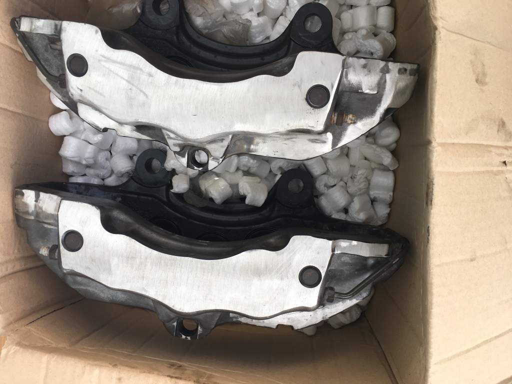

All stripped down and in the powder coaters since 3.45pm :clap:

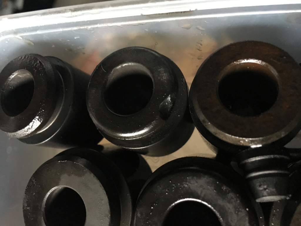

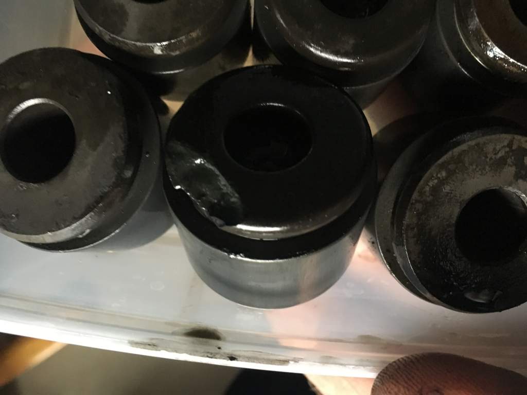

Going to have to order a couple of Pistons along with the seals etc, a couple of them were quite brittle (like porcelain) and chipped off:scared:
Should be back from Powdercoaters by next week:thumbup1:
How did they get damaged?
Just prizing them out Andrew, had pressure on both sides to pull them up cleanly but 2 just chipped off, they're about £20 each to replace, so it's not the end of the world, they're different to both the SRT8 and evo pistons in that they don't seem to be metal. they're called Phenolic pistons?? Seem to be like a porcelain/composite material.
I did bud, it was literally just prizing them out the last few mills, the Pistons popped out a lot easier than the other sets, they were just brittle

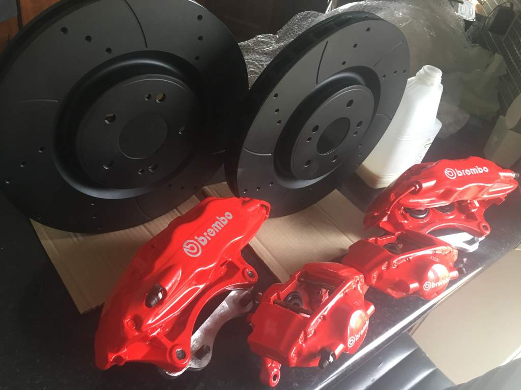

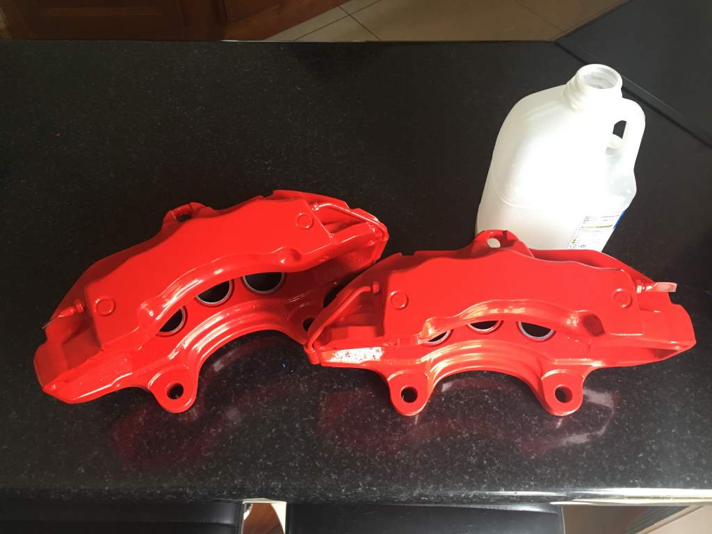

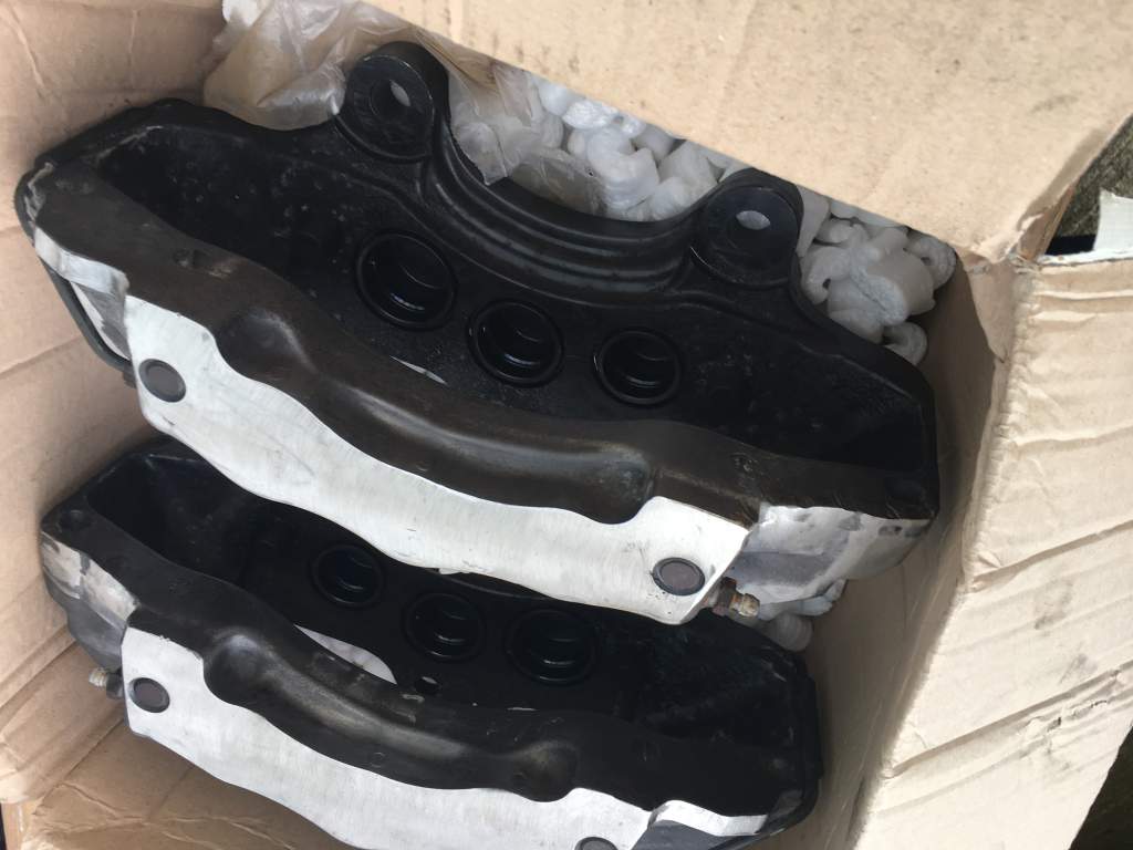

All my caliper rebuild parts arrived yesterday, planned on building them today, called into the powdercoaters yesterday, who showed me them baking in the oven:whistling: went to collect them this morning and the finish was terrible :thumbdown: it was like they'd contaminated them with grit:scared: the fronts were perfect but I told them I wanted them re done, first time I've had this happen with them, so we'll see how it goes next week:yes:
Hope they get it right this time mate.
Ah yeah, I don't think the regular guy painted them, he'll do it right this time.
Plan B is a go!!
Powdercoat is much better this time:yes: The guys told me they tried to ring me to tell me not to go in on Saturday, as they were not impressed themselves with the finish, they also knocked off a few quid by way of an apology :thumbup:

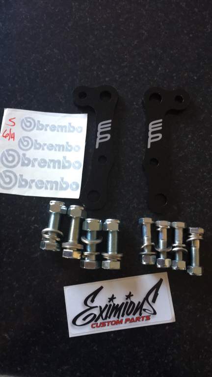

My custom brackets arrived also but Customs were looking for €70 Duties:scared::thumbdown:
Lodged a query and they're on the way back for assessment :whistling:

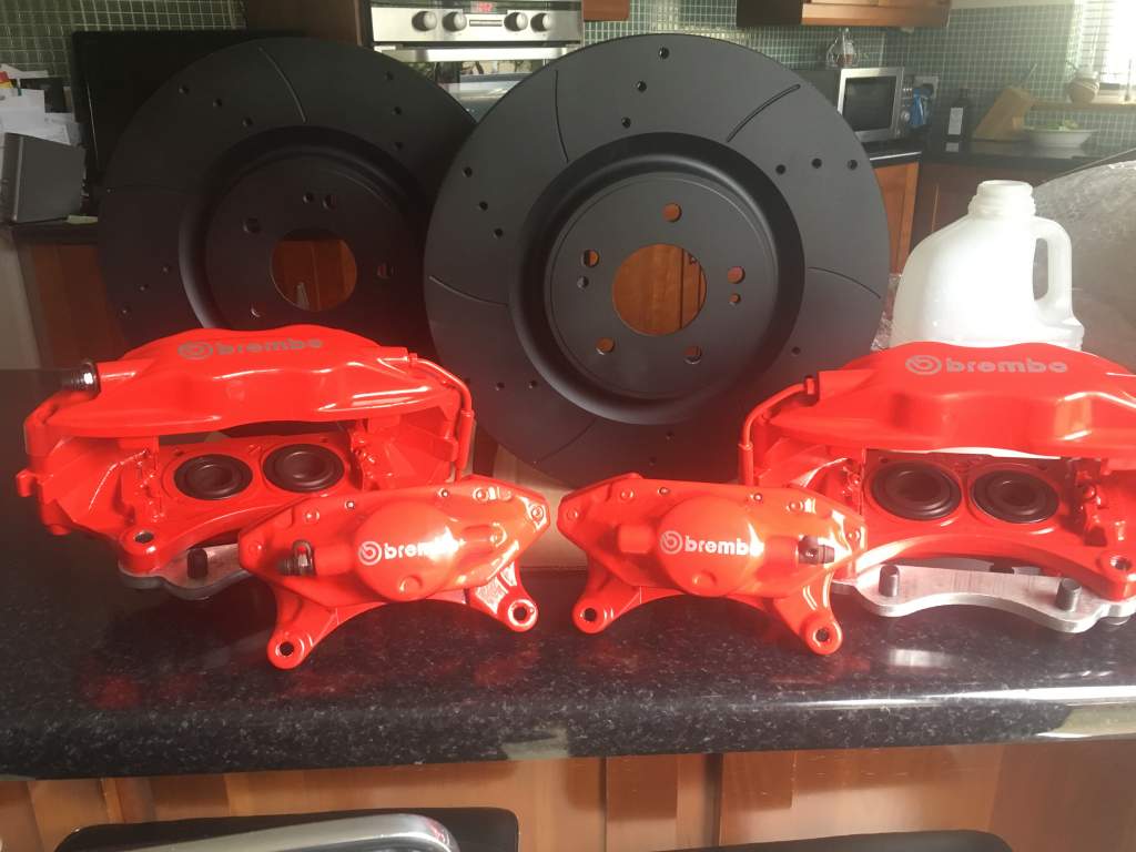

On another note, my guy has finished building the Evo BBK and all parts are here ready to go to Jimmer for its new owner:thumbup:
Hopefully he's a happy chappy seeing this:innocent:

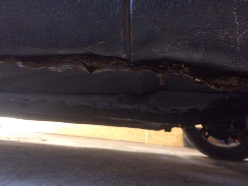

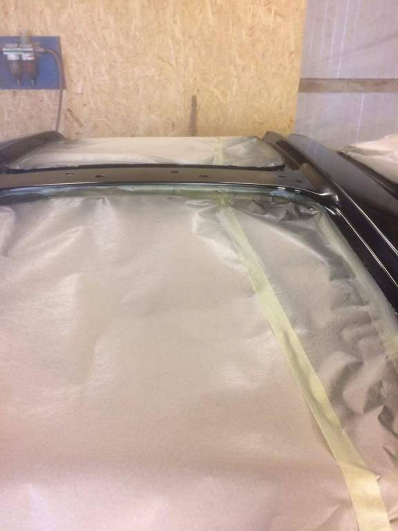

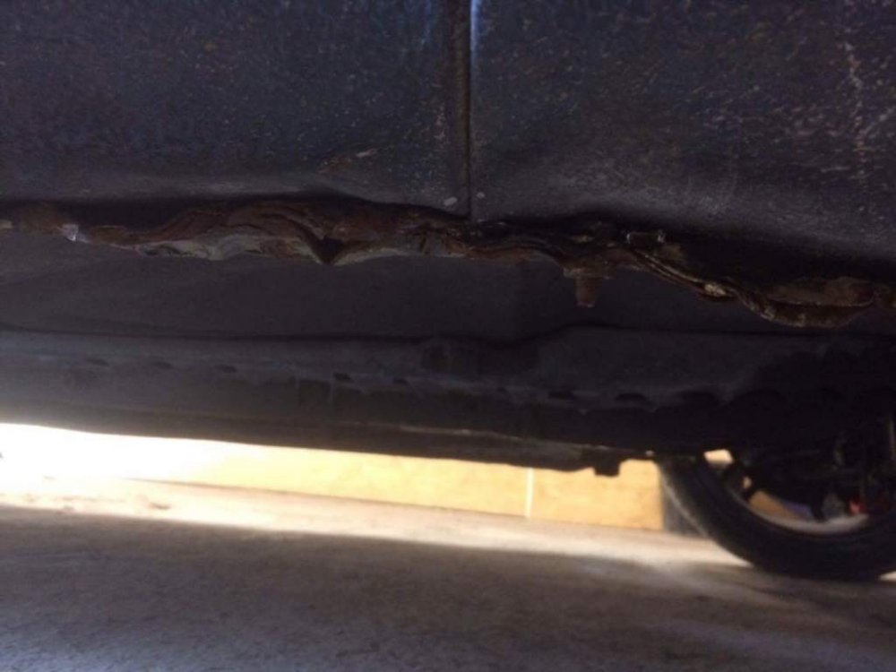

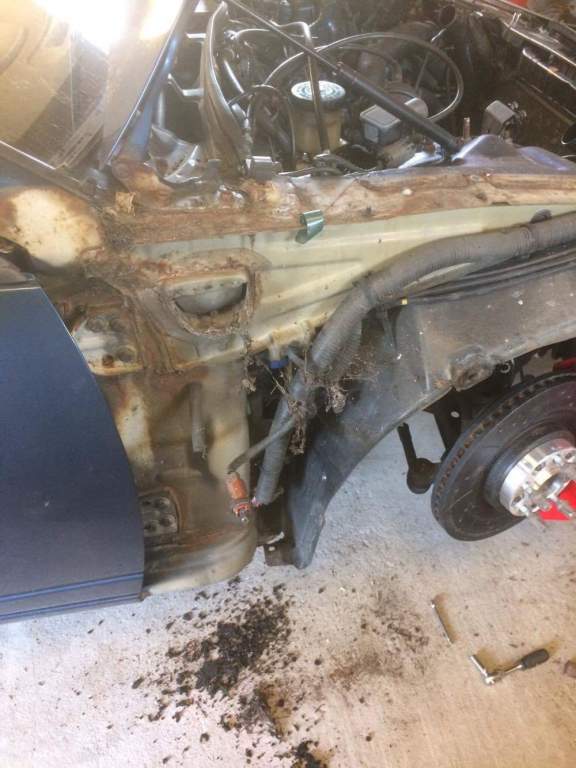

So, I've pestered Keith that much, that he sent me a few pics that scared the "Bejesus" out of me:scared:
He's told me he's not sending anymore until it's finished but that all the scary stuff pictured has been rectified :bow::bow::bow::nana2:
The mans a "Bleeding Legend" as they'd say in Dublin:biggrin:
Anyway, here's the horror....
:shock::shock::shock::shock::shock::eek::eek:

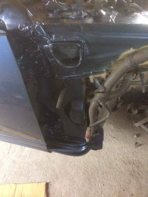

Things looking a bit better..:yes:..

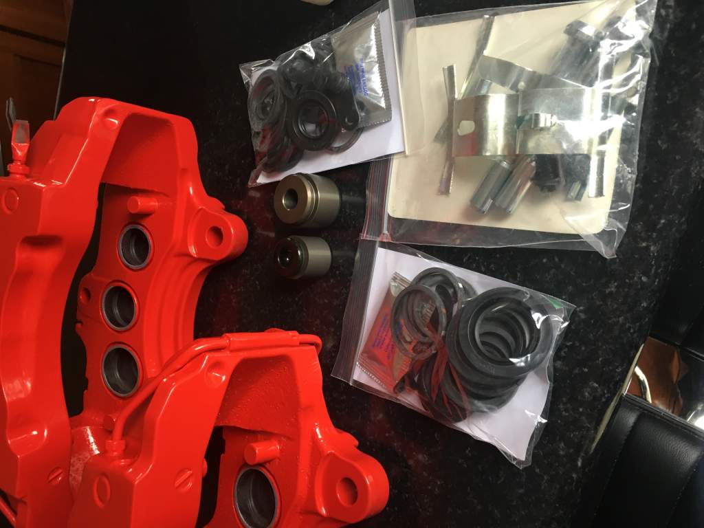

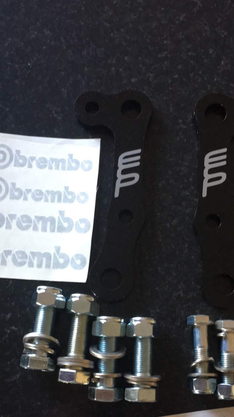

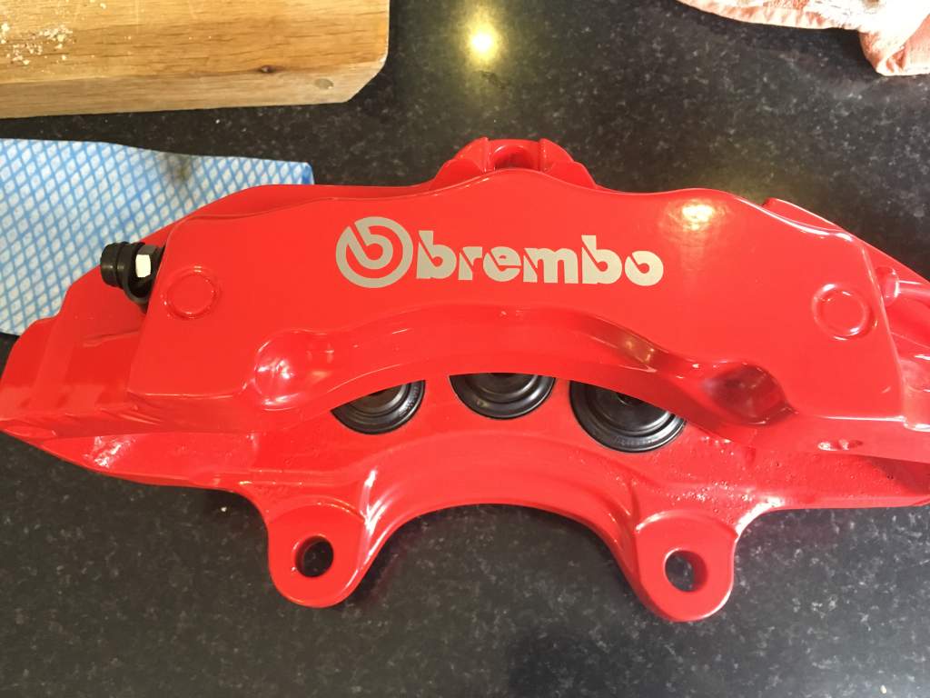

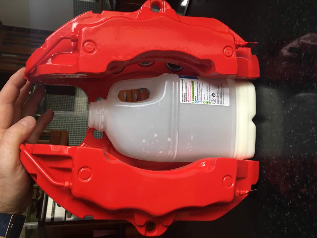

So, worked all weekend and my brake guy has come back to me saying that the powder coaters got some around the piston chamber grooves for the dust seals, I should have known when the foam blanks were rock hard and shrivelled up:thumbdown:. Obviously when they re-did the coating they never replaced the blanks and they shrunk more by being heated a second time, dust seals now won't fit:scared: he cleaned one out after about an hour, but he's split one seal test fitting it. I'm now trying to clean them all out with a small jewellers file and have to order another set of seals :thumbdown:
Oh the joys of it all:innocent::whistling:
On a positive note my brackets and decals came today after being re-assessed by Customs went from €70 down to €18
Edited by Richie K
Been busy for the last week......
Filing Goddamn Powdercoat out of the caliper dust seal grooves!!!:censored::censored:
Finally finished them off and managed to remove my fingerprints off my fingers also.
Always the way with your own stuff, every other set of calipers were spot on and hassle free, mine are still wrecking my head:thumbdown:

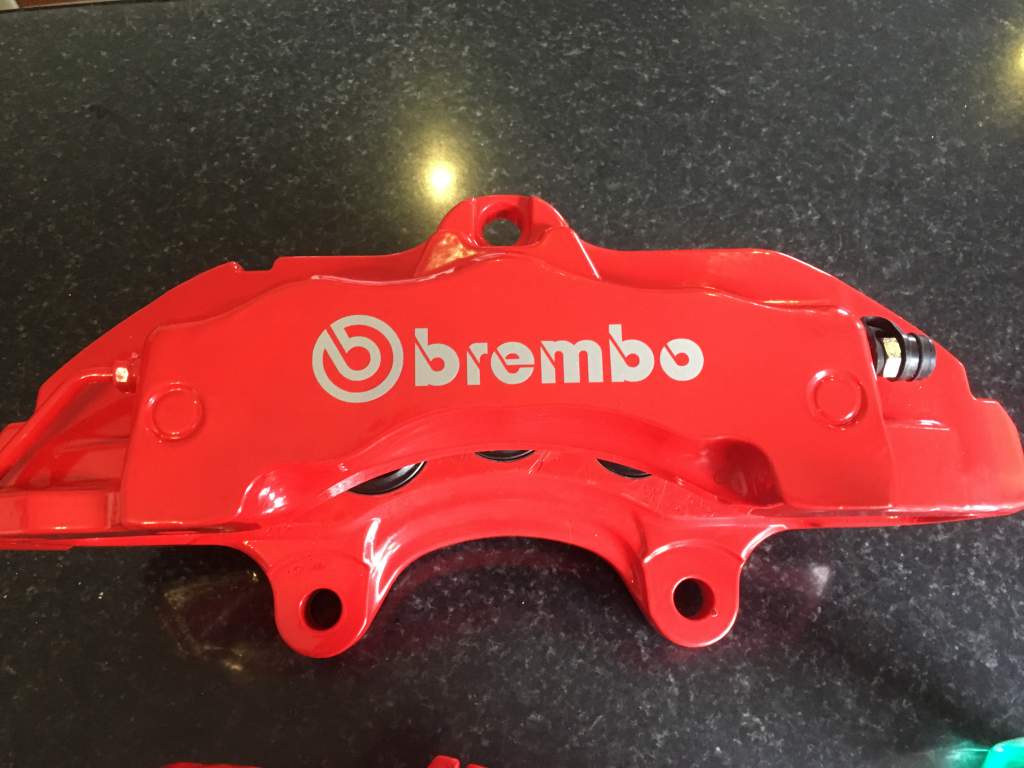

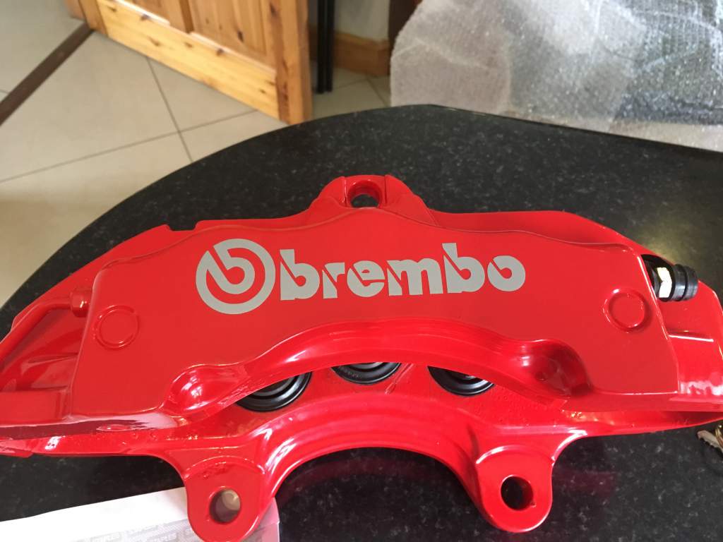

Tried fitting the decals and they were either too big or too small
Too big
Too small
Just right
Unfortunately for me, I've only got one decal for the "just right" size, so have had to order another 4.

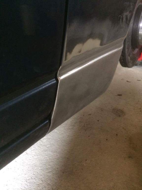

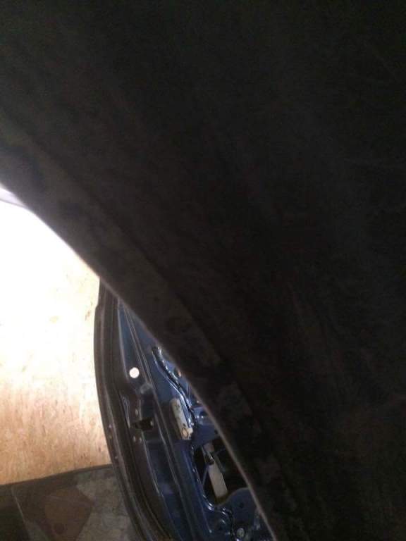

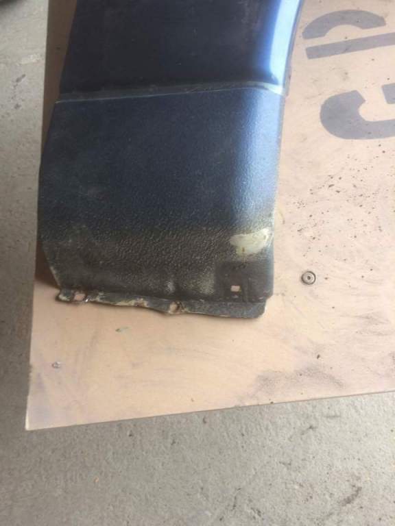

Wings were a little worse for wear

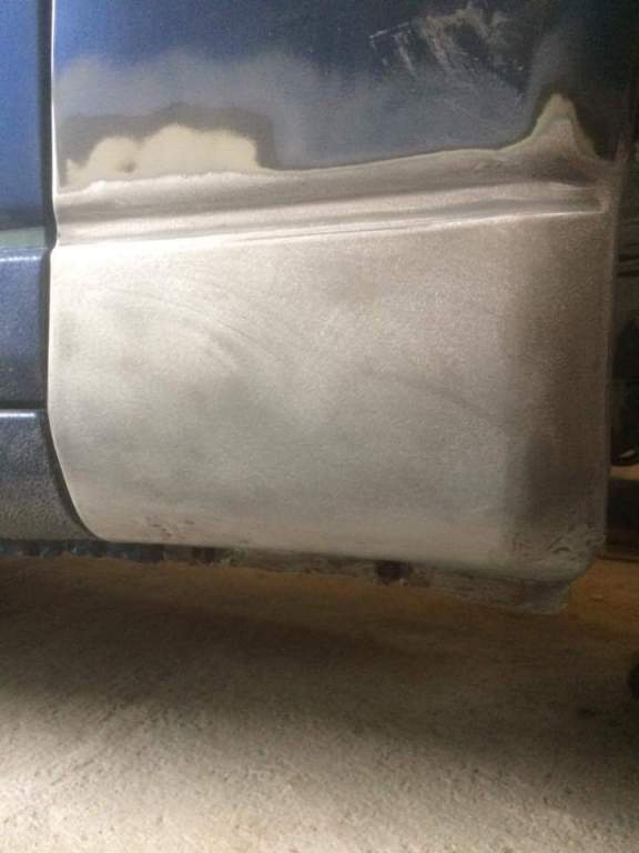

Tidied up
Repaired wing:clap:

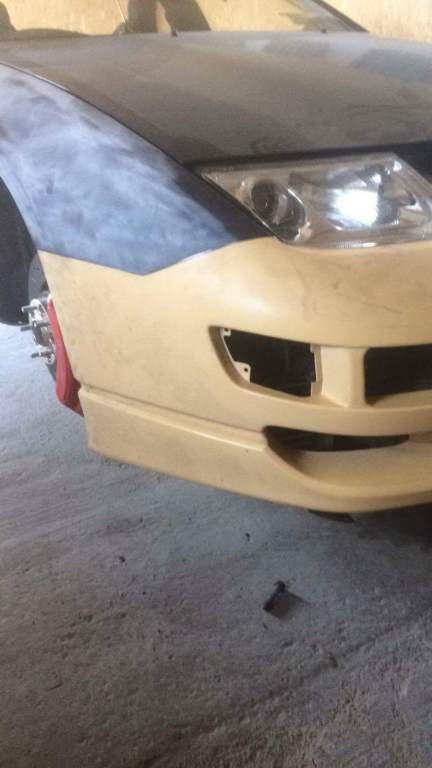

Front bumper test fitted after a bit of fettling with the Greddy Intercoolers

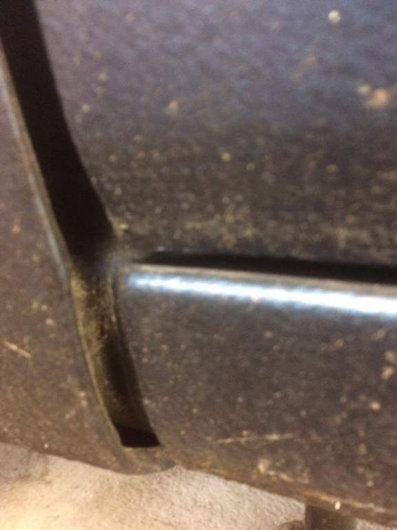

Wheel arches rolled flat
IMG_5284.jpg:punk:

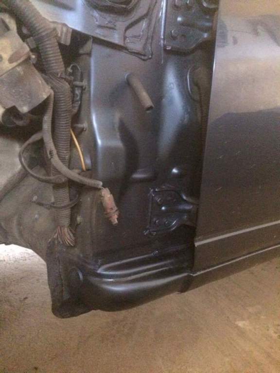

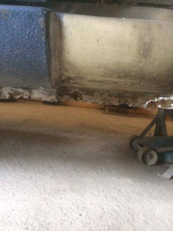

Passenger inner tidied up

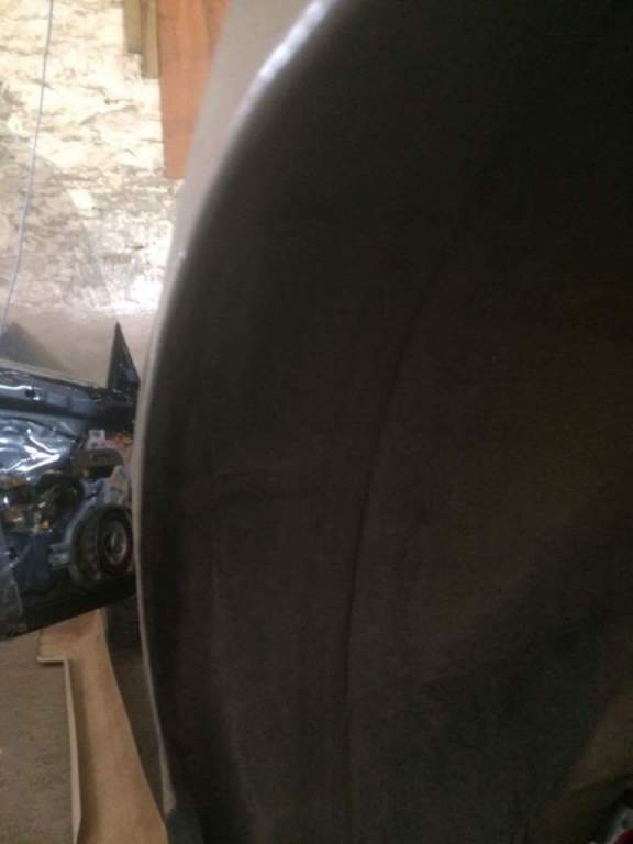

Has he managed to stretch the rear arches for the big rims?
Yup:thumbup:
He says he's pulled them out as far as he can, without "major surgery", :innocent: I'm hoping that it's enough as "major surgery" sounds expensive :whistling:
