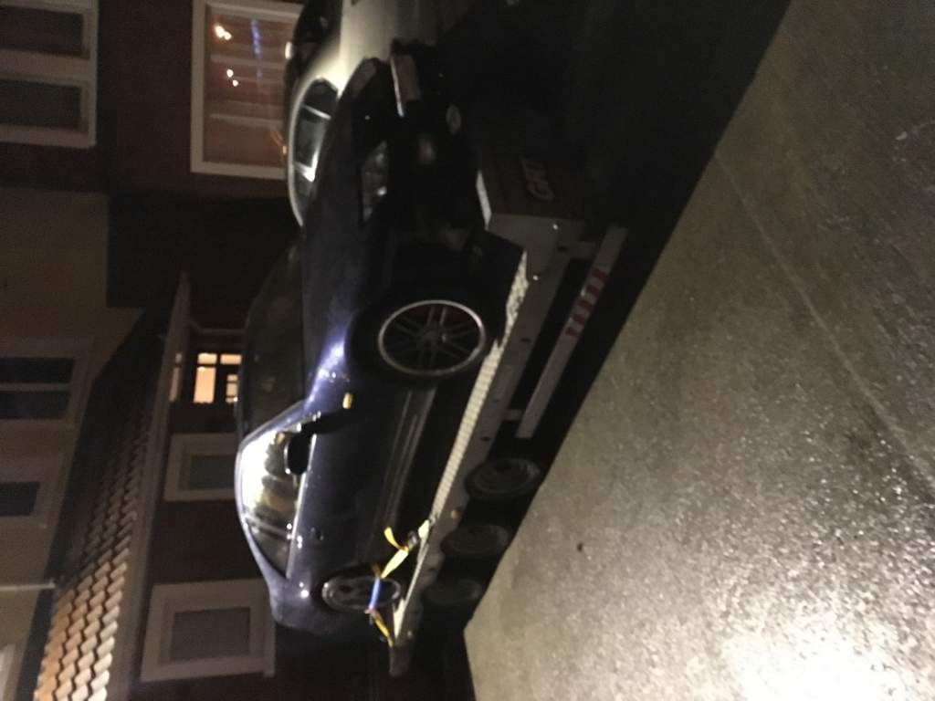

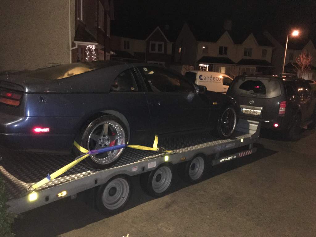

Here she is all packed up...

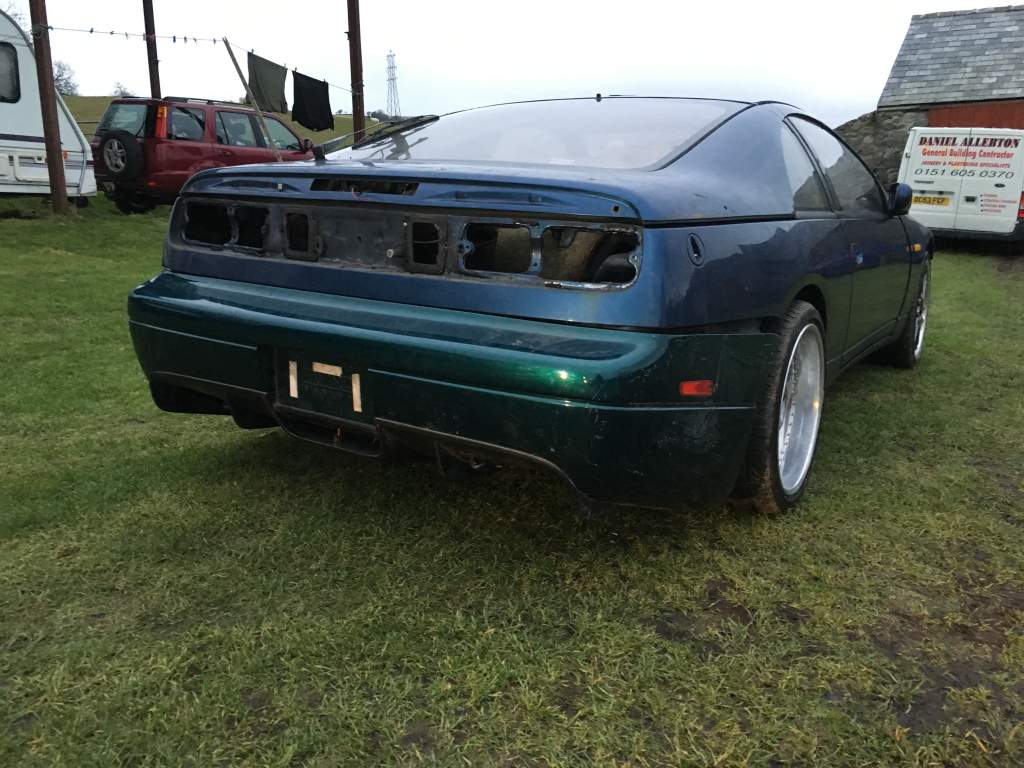

Got back to Keith's for 4.30pm today and I have to say, he doesn't hang about!!:bow::bow: Rear lights out, rear bumper off and Twinz rear test fitted.

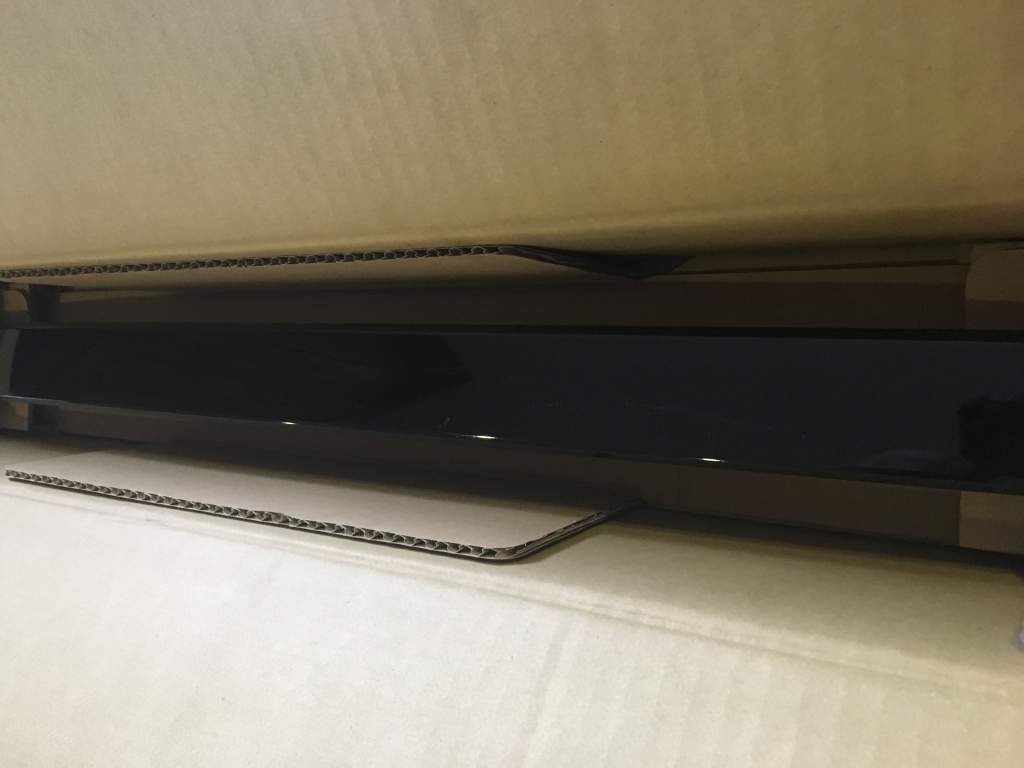

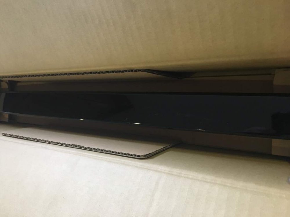

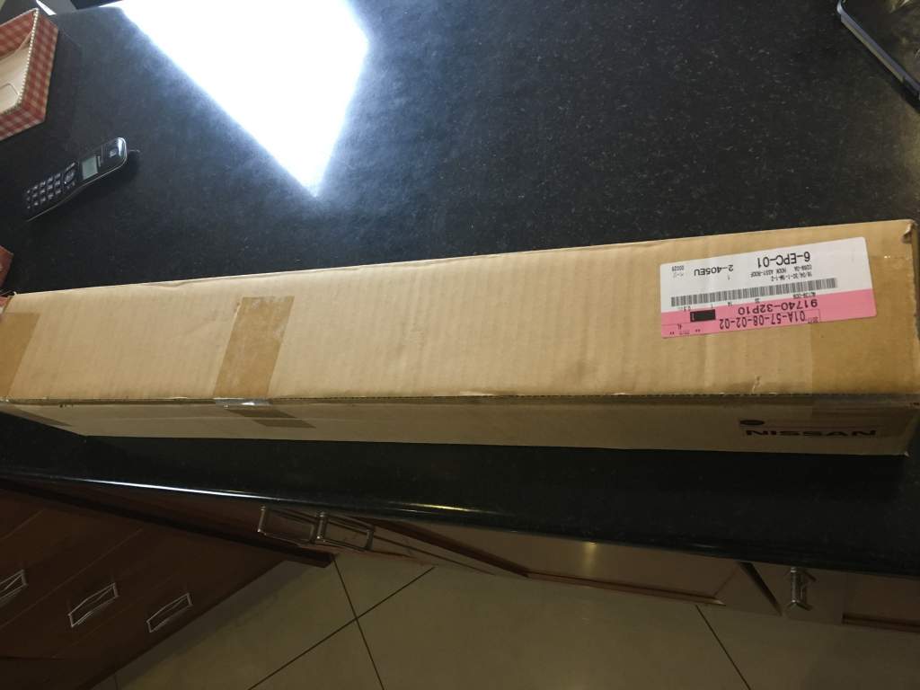

Last piece of my Z puzzle:clap:
Had paid for it in March '16, left it at Nissan with my other bits, collected everything and they swore blind that they'd already given it to me.
Got them to check again and guess what?? They found it in their store. So this is being shipped off to Keith's along with my red nose badge:thumbup:

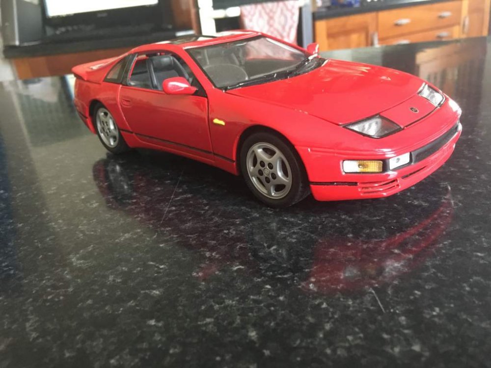

Haven't been doing much Z related the last while, bar saving up and paying for my respray :thumbup:, I did however get offered another SWB TT in red and said "what the hell", the guy let me pay him off in installments so it took the sting out of it:thumbup:
Pics
These Kyosho models don't come up very often (expensive when they do) so figured when they're offered to me for a reasonable amount, it would be rude not to take them:yes:

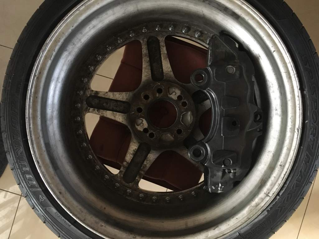

So after trying a few different ideas regarding fitting my 18" Veilsides over my HUGE Brembo 6 pot front calipers and failing miserably:thumbdown: I'm now moving to plan B:innocent:
I will be selling my front setup, newly powder coated 6 piston Brembo calipers with brand new, seals, stainless bleed valves, adapter brackets and brake pads (same as R35 GTR), You can get 18"s & 19's over them if they have a minimum internal diameter over 450mm, unfortunately for me, I want to keep my Veilsides which are 450mm but step down to 435mm.

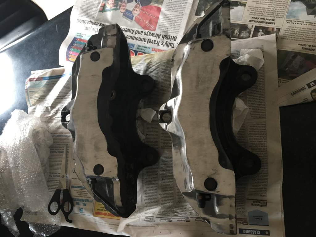

PLAN B:clap:

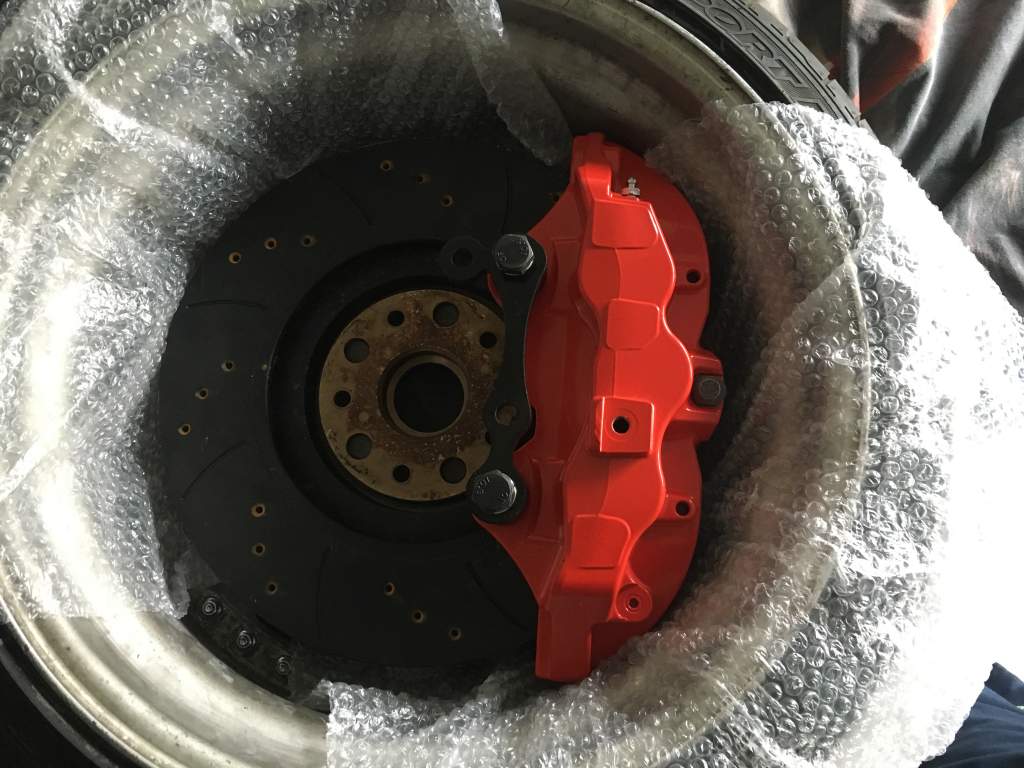

Just got these babies delivered, back to square one... strip them down, order new stainless bleed valves, new seals, new pads, new hardware (pad springs+bolts), send them for powdercoating and then rebuild. Pretty much what I've just done on my other ones.
Where my larger set are 355mm in length, these are ONLY 325mm, thus the 30mm less should fit inside my Veilsides :thumbup:
Quick comparison between the two calipers sitting inside the wheel
