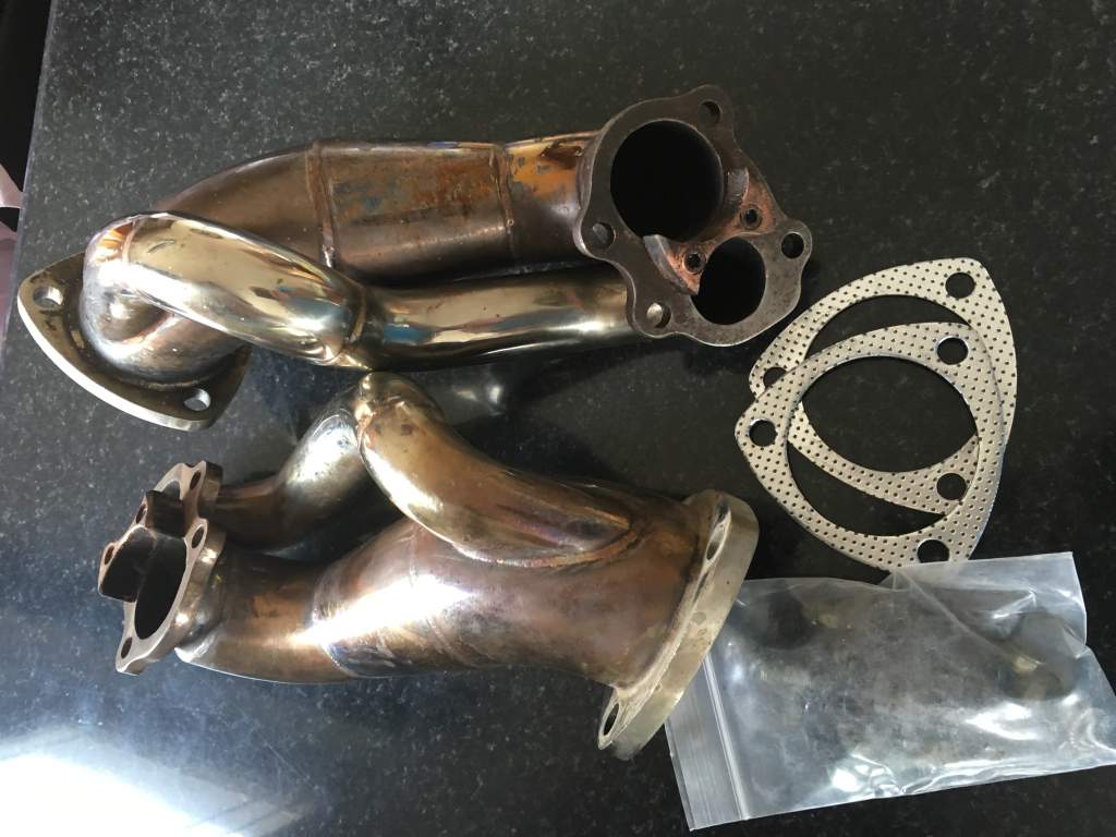

Last piece of the jigsaw arrived 5 mins ago.
3" Downpipes to fit up to my full 3" system.
Big thanks to Ash (ADL Phoenix) for sorting these out for me:clap:

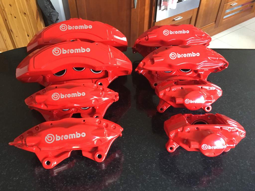

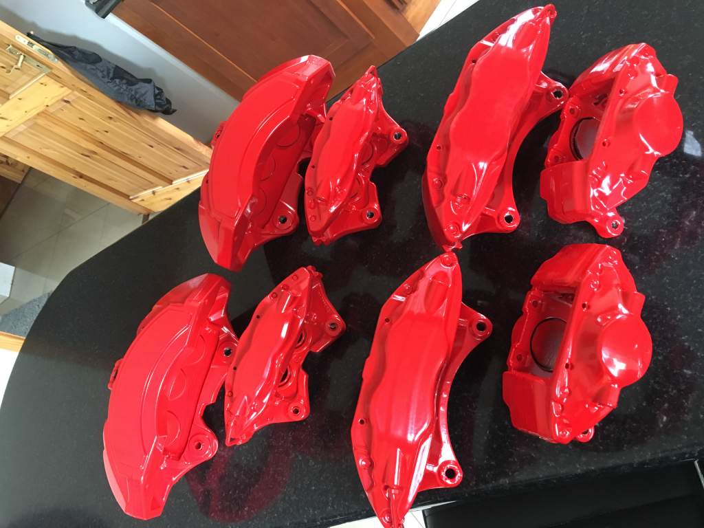

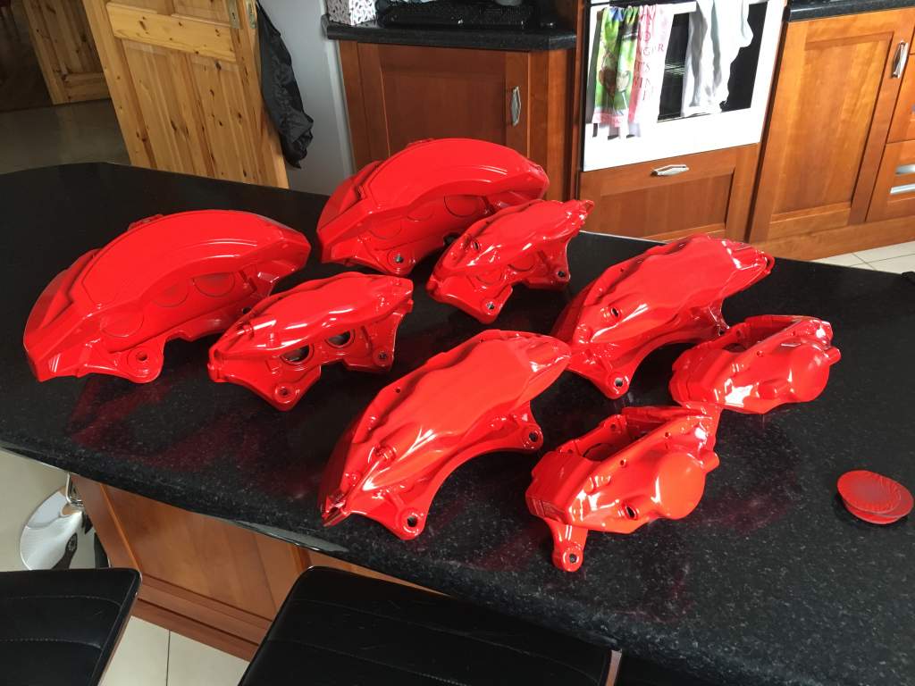

Going to have a busy day today, powdercoaters rang me at 8am to say the calipers were ready for collection.
Going to get stuck into rebuilding them and checking fitment on my rear hubs at least:thumbup:
They look great, Richie. :thumbup:
Why the hell do you need eight calipers though...??
Thanks guys:thumbup:
I'm going to be using the set on the left Gaz, 6 pot fronts and 4 pot rears:punk:
I'm greedy Si :tt2::innocent:
I'm doing up a set of Evo calipers for a buddy:whistling:

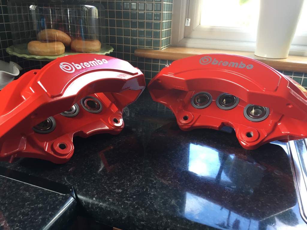

All cleaned up (blanks removed) and decals fitted, moving onto the stainless bleed valves now

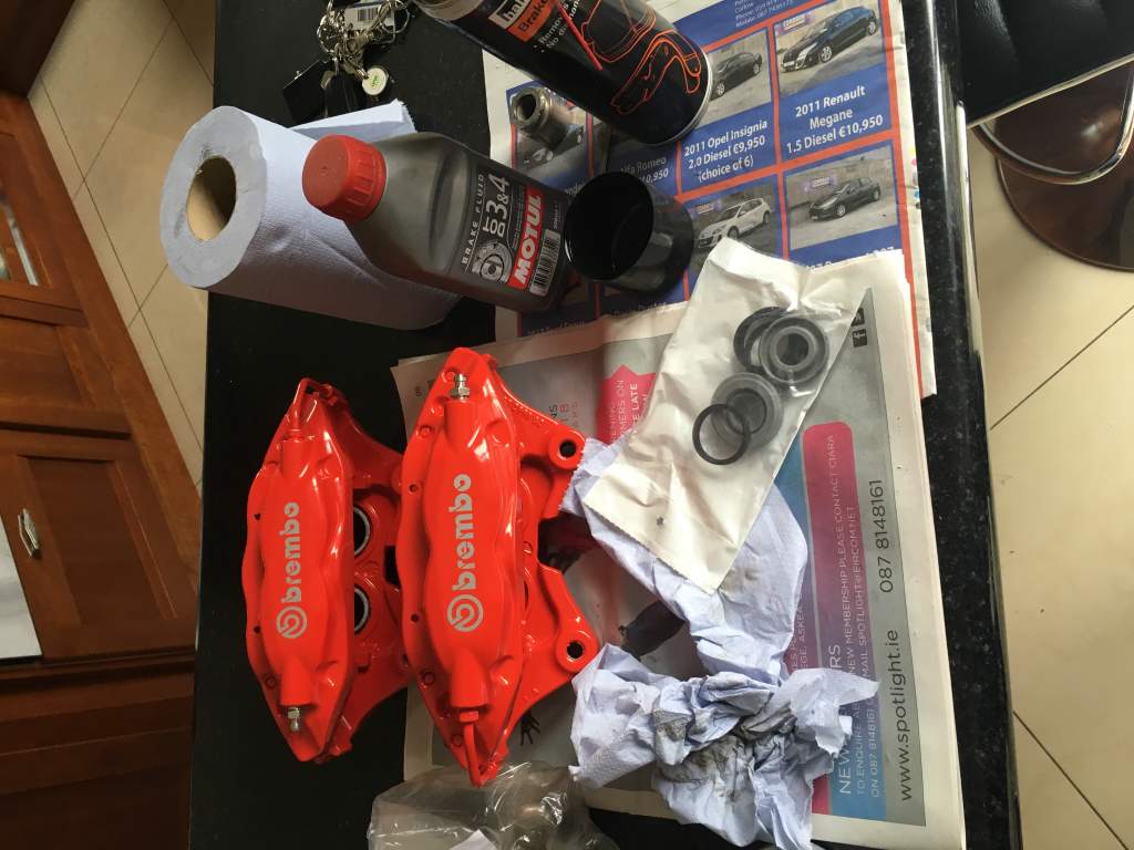

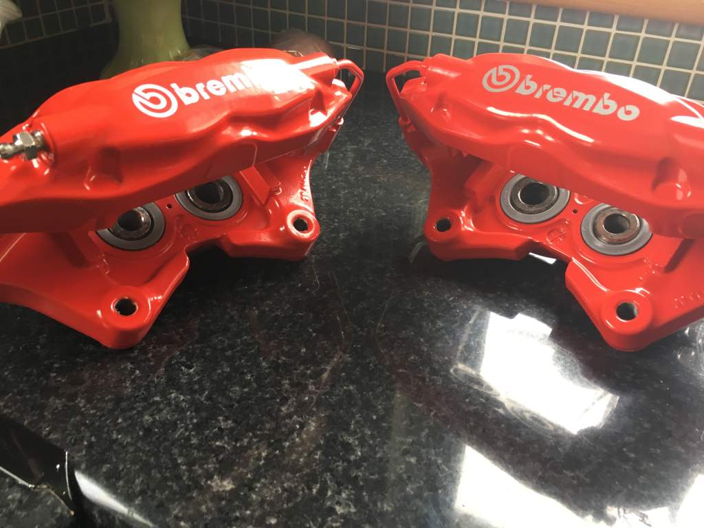

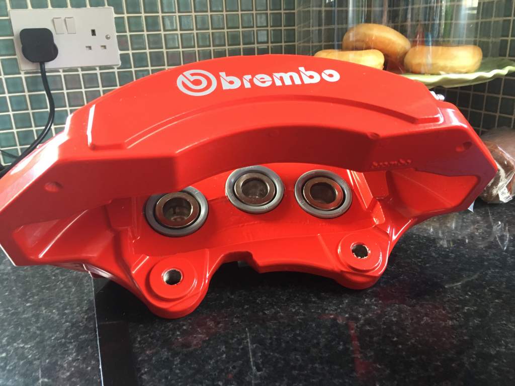

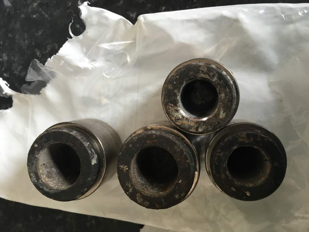

All the stainless bleed valves fitted to both sets, and managed to fully rebuild my front calipers, new dust boots and seals, will do the rears tomorrow :thumbup:
So sorry if I missed it, what calipers are you using at the back with these SRT8 fronts?
I picked up a set of Chrysler 300c SRT8 rear calipers Steve, same as the Jeep Grand Cherokee '07- '12 model, the newer ones don't fit our Z's but they do fit the Supra and 350/370z:thumbup:

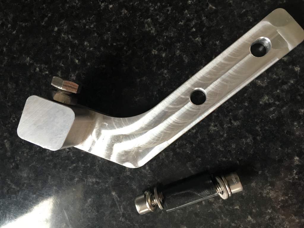

Got my BMC brace off Iain Knight this morning and I have to say, it's a nice piece of kit, comes with stainless fittings:thumbup:
Thanks Iain

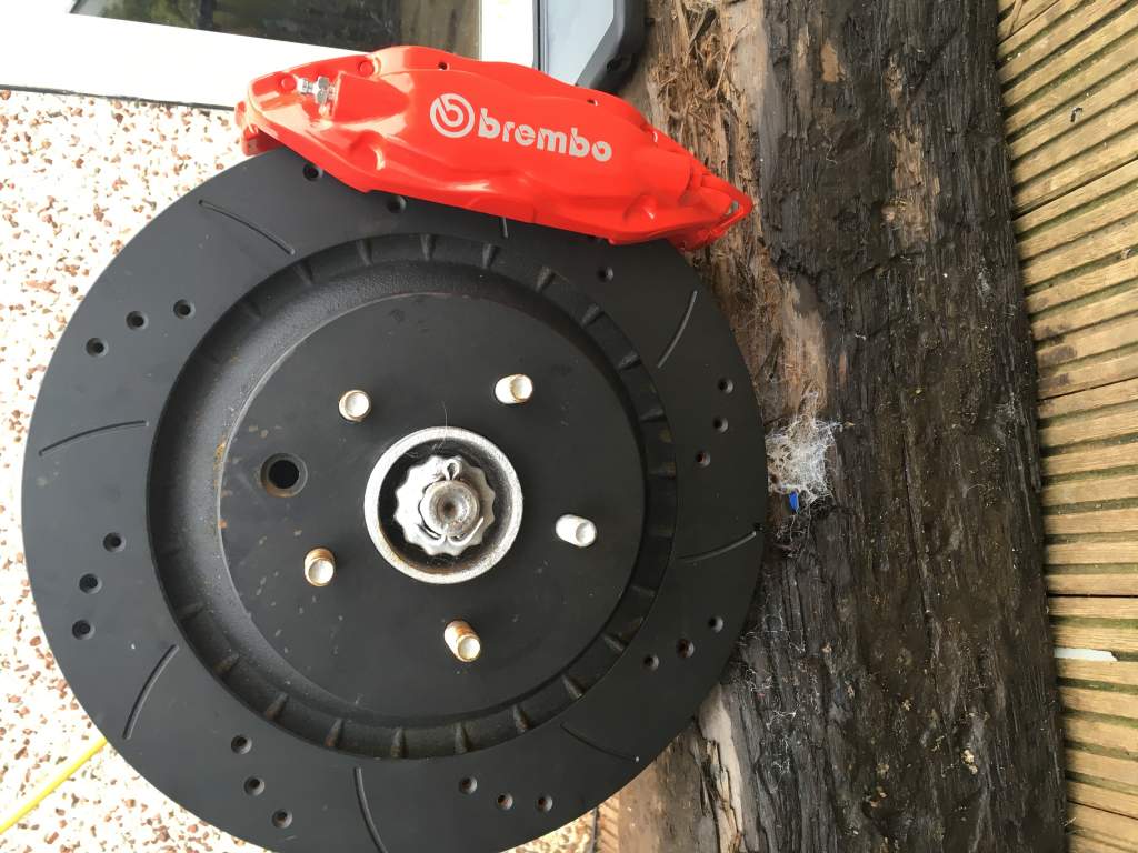

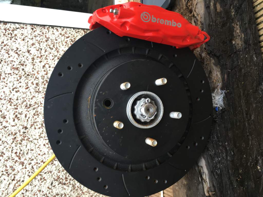

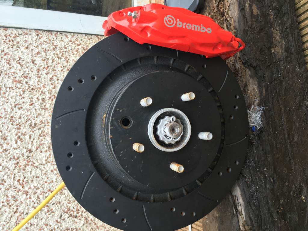

Test fitted the drivers rear caliper for fitment, need to shave a few mils off to get it to sit perfect but it gives you an idea of how it's going to look :thumbup1::thumbup1:
