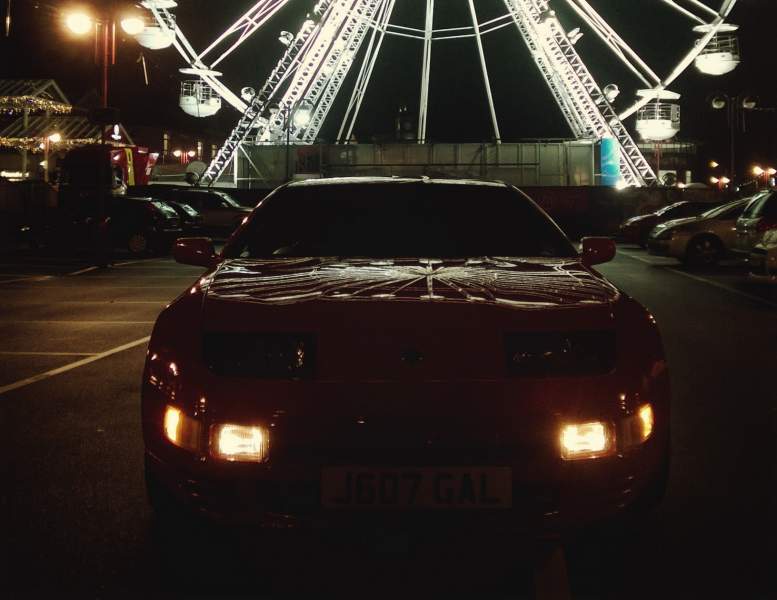

Somebody might of fiddled about Lee in the front corner and i think it could have a different indicator stalk assy to enable it all to work , one wire in the corner becomes live when you have the dipped on, so of course this goes to the bulb and shares a ground with the indicator bulb.

But they not usually bright enough to light up the next lane Are you sure it's in the indicator and not a fog light ?
I'll check it shortly as haven't actually looked.
But it comes on with the indicators and its direction is pointing to the side rather than front.
That's what Jeff told me anyway
Most Jap spec Z's have them and they are on my swb. When you put your indicators on (at night when your lights are on)the kerb light will go on that side to help illuminate that corner of the road.

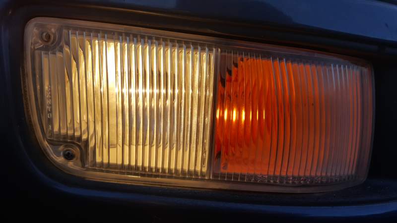

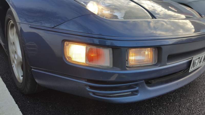

That position yes but they only come on when you independently signal that side, usually that position on a 89 spec lens as a drilled out 501 bulb and holder so it won't really light up the road like Lee said............think he'd had a long journey !!!
ah right... these are not the 89 spec lights on mine with the drilled out bit... I got them off Ian earlier in the year and they have a proper bulb holder. Not sure what spec they are but they match the lines on the fogs

They'll be a 21w bulb behind there, same as the stock reverse lights......so yes it will kinda light up the road :thumbup1:.
