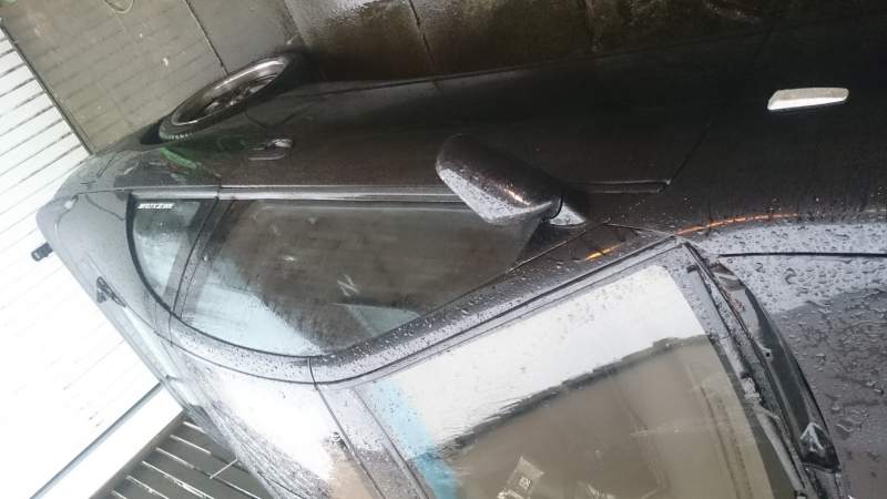

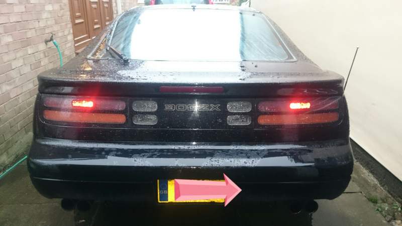

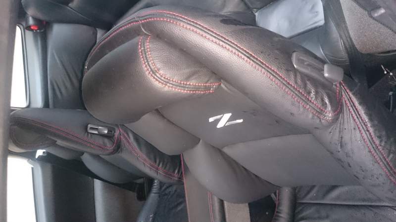

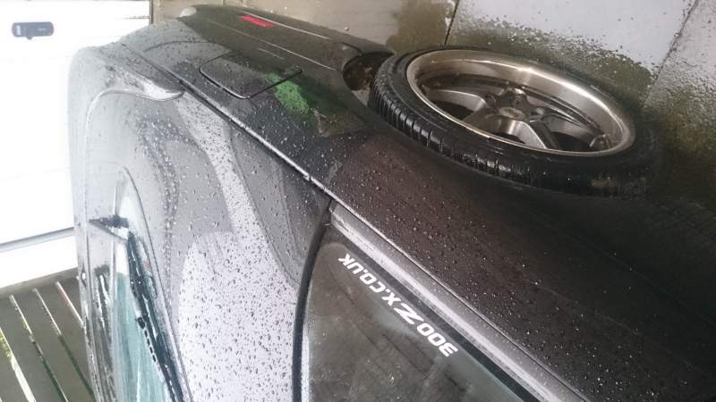

Well tomorrow is the day I've been waiting for..my Z32 na manual is arriving!!! :)
Being a 80s/90s kid, I've misspent many an hour admiring the shape of the 300s, along with certain shapes on my baywatch posters no doubt! Ha.
Anyway, she's in a bad state, and I'm under no illusion that it'll be easy project, but looking forward to working on her over the next few months!
Wish me luck! ? ?
