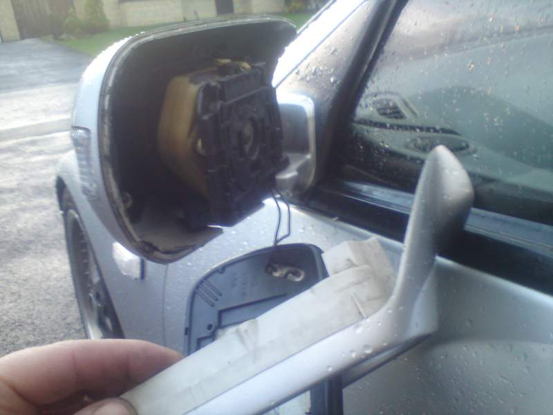

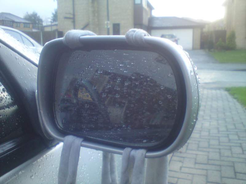

I had a little job to do in me changing the indicator on my door mirror and I wasn't aware you could remove just the housings without taking the door card off, etc, and then remove the all shebang....but you can.

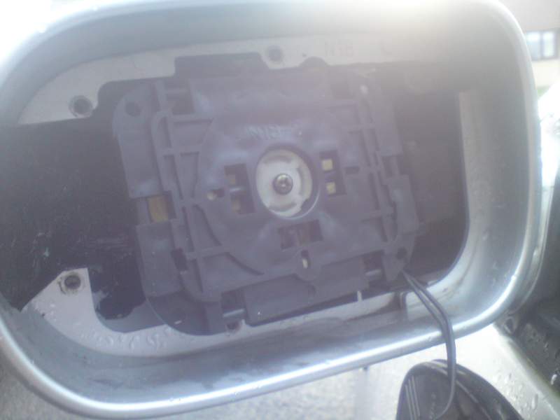

First get some strips of rag and then pull off the mirror, mine is the heated type so hence the two wires in the 2nd pic and just leave this dangling if you don't want to unplug that is.
There are now six screws to remove, 3 on the top and 3 on the bottom, you can remove these with the window up with a normal length screwdriver but of course the mirror needs to be in the 'out' position. Please note i have a cut away part to the left on the pic to enable the indicator to fit in. After removal of these six screws the front part will now come off.

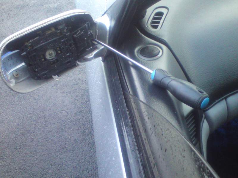

One more screw now and it's on the end of the screw driver in the pic below, you can remove like i have done with the window down or struggle with a stubby with the window up. The back will now come off with a little jiggle/force or if you like close the mirrors in and the back practically falls off so be careful, use this closing in method when you refit this back part, you'll find it much easier and put that one screw in but you'll need the window down. Fold the mirror back out once this is done, now refit the front part and those 6 screws.

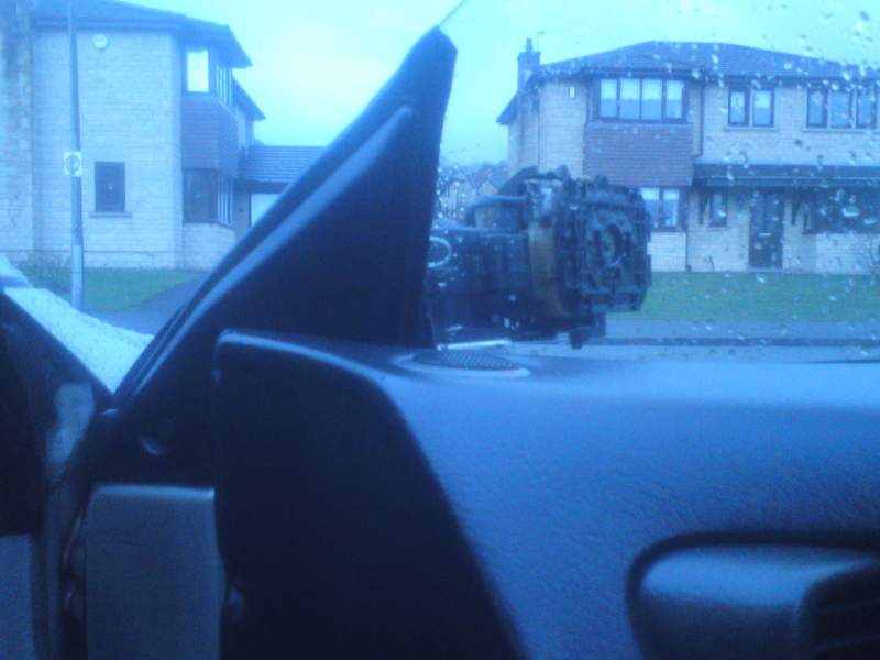

Of course now you end up with this, i even left them like this, open to the elements without a problem. Notice the bottom screw bolt is still attached, this does not need removing.
I haven't touched anything internally, saved me a lot of time, even though door card removal is not a big issue i was so pleased i could work this way especially dodging the showers like today.

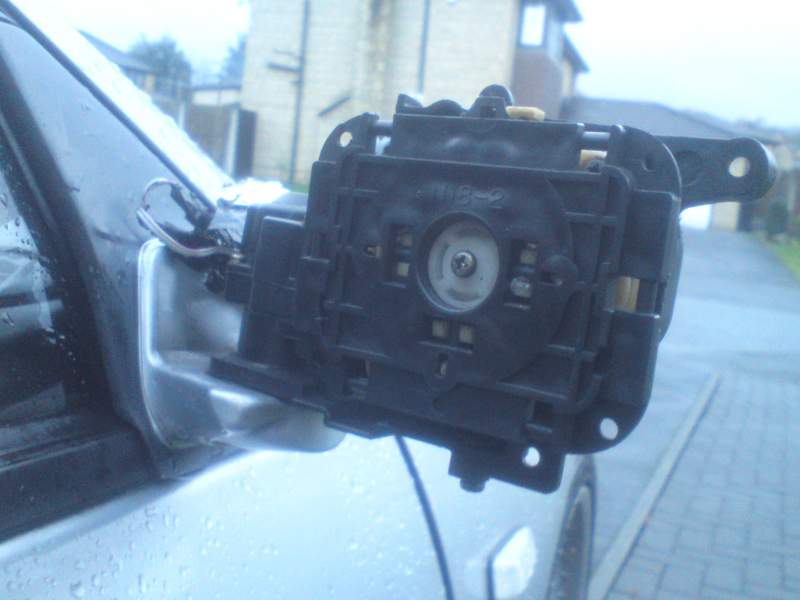

Dangling mirror.

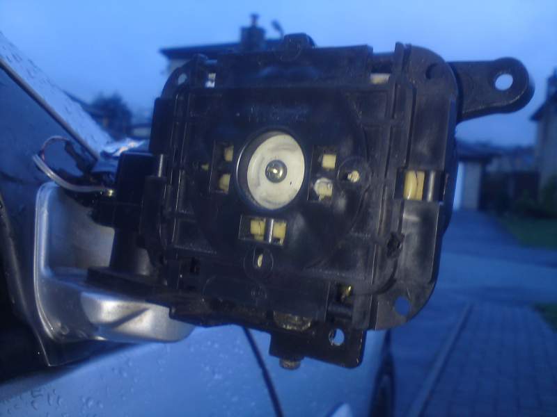

And another pic showing the part the mirror itself engages on.....at the four lugs, just offer onto these and press home, if you didn't know that !!
