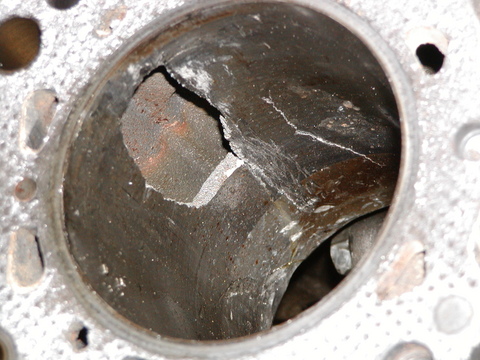

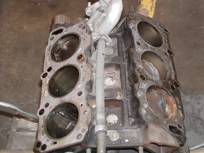

Sounds (excuse the pun!) the right approach. Have you see this info under the "The Engine Block" section regarding overbores?
http://www.superstreetonline.com/how-to/project-car/9909scc-project-nissan-300zx-part-4/
You can see how much (little) material is available in these photos of a stock VG block that has let go in No 6 bore.

wow that really is thin, seems any boring out is not a great idea
Thanks that's great information, might look into cryogenic treatment, interesting they stopped at 89 mm maybe that would be safer in the long run.
