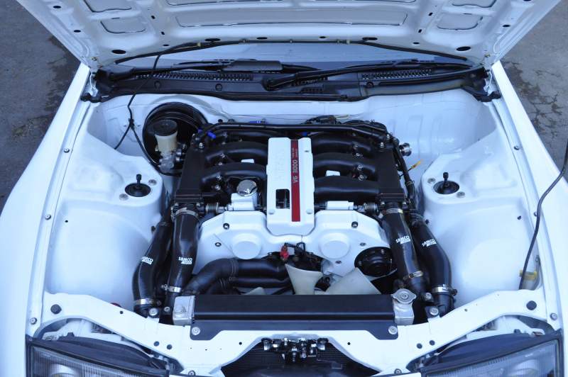

All of it
It's surprisingly easy to work on now, the only pain is the balance bar- this may go at some point
I recommend you start with deleting:
The aivs
Egr
Fuel pressure boost unit
Water bypass
Ptu relocation
Further to that you can
Relocate battery
Relocate fuse box
Relocate pas reservoir
Delete hicas
Wire tuck
Boost solenoids
Fuel damper
There are a few more but I can remember
That lot will keep you busy over the winter
Did I mention I'm no mechanic lol, that engine bay looks super smooth, I'm a long way from there though lol.
That is super smooth and quite a dedicated long process to get that result.
