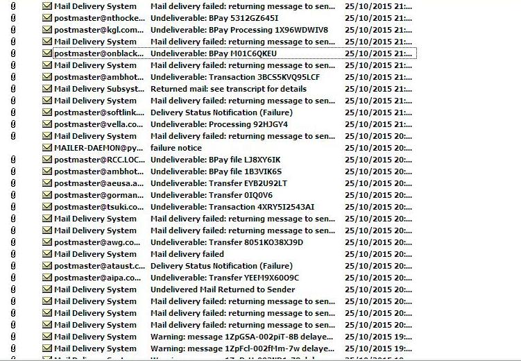

Groan..... been here before with one of our many emails I use, last time was getting 500 non delivery reports a day, as its an e-mail attached to a web address the host company flushed the server and blocked loads of Ip addresses, this was like a year ago an no problem until three days ago and my question are they complete fake non delivery reports, or is the email address been used to mass email and the non deliveries are due to spam alert from the receivers mail system?

They may be genuine but unfortunately your email address has been used as the source of whatever spam that was sent.
The person who's sending the spam simply spoofs the email header and inserts your email address as the origin.
Receiving servers then reply to you rather than the original spammer.
It also could be that those emails themselves are the spam and that they are designed to make you investigate what you
think could be wrong and you end up opening one of the attachments which could end up hijacking your pc via a virus.
Its likely a combination of the two scenarios and what ever reason your email is been targeted.
Is the email account you use publicly advertised anywhere for spammers to pick up and use ?
Each mail has the following text or similar and each has an attachment ( oh yeh!) but the apparent address they have failed to be delivered to is different and they are really random sounding ones such as n4wz4c7m@n.wholesalejerseyssupports.com b.saito@soe.com b0nidsgk.8352188@nifs.com.au
1000010740_10007298@candabcseek.com and such like all of which look like fake mails anyhow?
