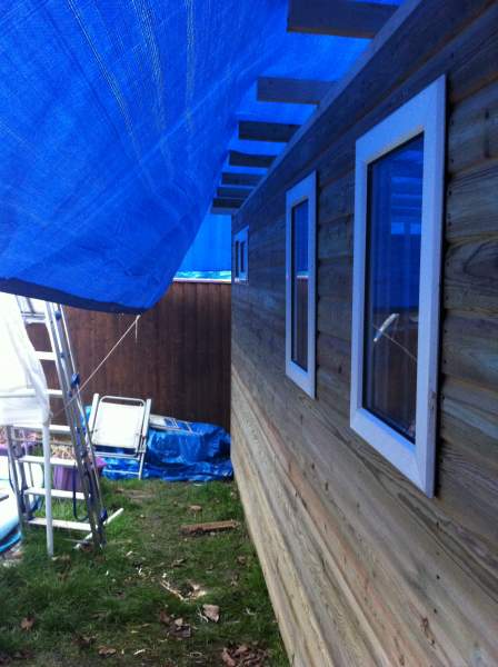

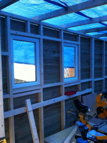

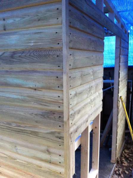

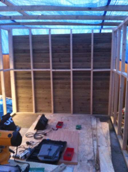

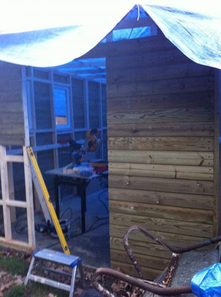

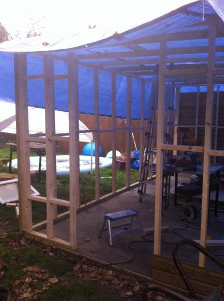

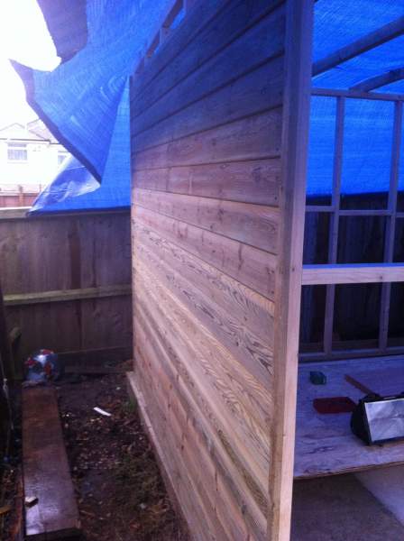

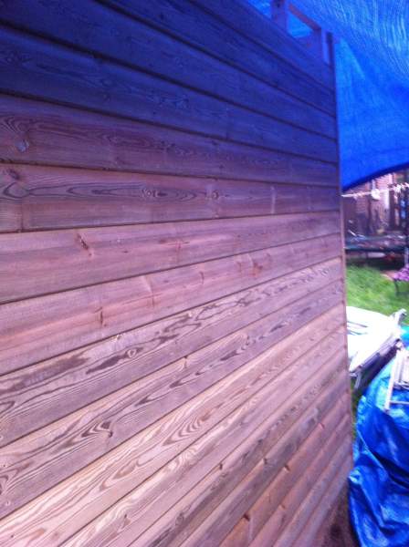

All noggins nearly done in, one end nearly clad and clad the bottom round most of it to make sure the levels are right, still got to cut out for the windows then continue cladding. Im so pleased i bought the huge tarp as its been raining on and off most of the day, but i was able to carry on working regardless, more pics :thumbup1:
:thumbup1: pay diesel and ile come down to give you a flat roof that will last at least 20 years Graham. Thats a mighty fine cave in the making there mate:yes:
Nice offer Bri, but ive got the felt and felt adhesive etc it would cost a few hundred quid to get you here lol
No i wish i had one, i have screwed everything :biggrin: i had a chance to buy a Dewalt nail gun really cheap, like £40 a while back and thought i wouldnt really have much use for it, then this lol, hindesight

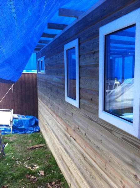

Wow, double glazed windows!
I originally bought the two square windows, closest in pic, for a tenner as they had no frames and my plan was to just use the glass and make a frame, then i offered them up as they were and thought they looked good, so they will be non opening and the the other window at the far end i got from my local demolition place for £15 and does have an opener, i wanted this higher up than the others as im partitioning the inside to accommodate a temporary spray booth, for doing bumpers and and small parts etc.

NB, unless the base is perfectly square, dont do what i did initially and set out the bottom rails to the edge, my frame for the base had been down over two years, before i eventually concreted it, so had slight warpage in the wood, so i erected the whole frame (4 walls, then squared it up before securing to the concrete base and the rest of the :thumbup1:roof rafters
