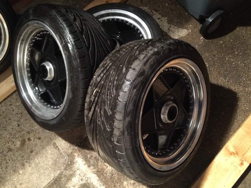

They're modena autostrada. Look like 17" 3 piece split rims. Price really does depend on condition but would have to be cheap for me to buy them so you might be better off putting a for sale ad up on the forum.
You're right, i remember the guy saying they were worth quite a bit to. These are in a sorry state around the outside but perhaps you're right, refurbed these would be a nice set to have on the car.
I was halfway through refurbing a set when I sold them & got some 18" wheels instead. I sold mine for £350, they were split down as well. I'm sure you'd get a lot more for them if you got them refurbed. Just avoid removing the bolts as it becomes a big job.

The centre prop replacement was a decent job but sadly the wheels are causing me much of the chassis vibration felt at speed. The light weight split rims i have on the car have obviously seen better days, so I'm looking for replacements.

Glad for you mate, tbh i never liked the rims on it anyway :)
I like them. If you wana sell them to me cheap let me know I'll put them on my teardrop trailer I'm planning to build.
