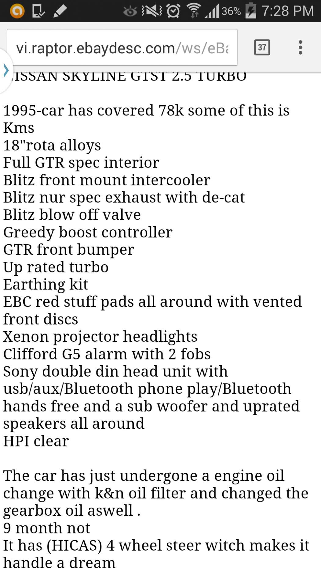

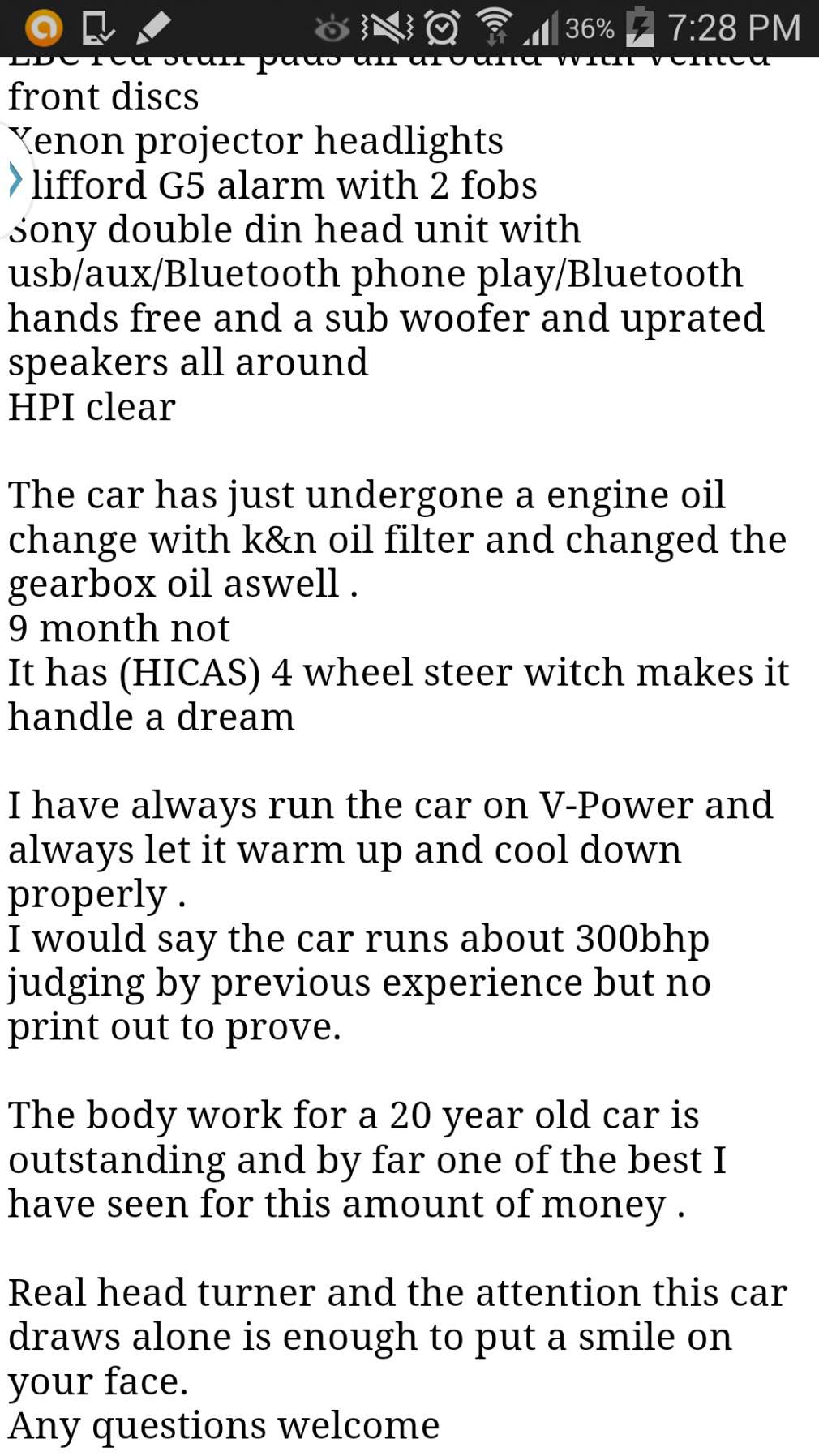

Problem is he bought is a bit blind, it seems a really good car but we don't know anything more than this advert. (It was a suprise to me by the way I knew nothing till the picture came through)

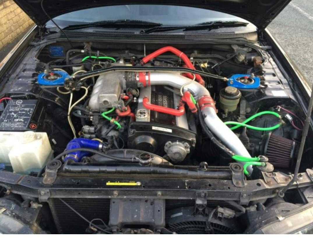

Im a but concerned that it has an aftermarket turbo, exhaust and intercooler and hasn't been mapped at all. And it has BOVs.
I will be grateful for any advice or knowledge you guys may have to help us make this car all it can be.

All r33's are consult, and yes it definitely needs mapping if it's got a different intercooler, turbo and whatever else. The standard ECU can't even handle a boost increase all that happily, so I'd expect it currently has a lovely flat spot at 5k rpm where the ECU pulls the timing back to 5 degrees.
