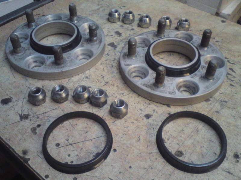

Are yours bolt on or slip on? These ones I have are bolt on which I'm keen to retain. You should check your wheel face as well because only Somme wheels can fit these spacers in 15mm due to the protrusion of the stud from the spacer face.

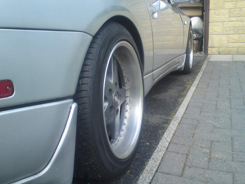

This is my rear set up, these Work Equips I have just bolt on and are flush :cool3:.

Further update, received today from Stephen the 15mm ones, very happy - maybe I fit tomorrow.

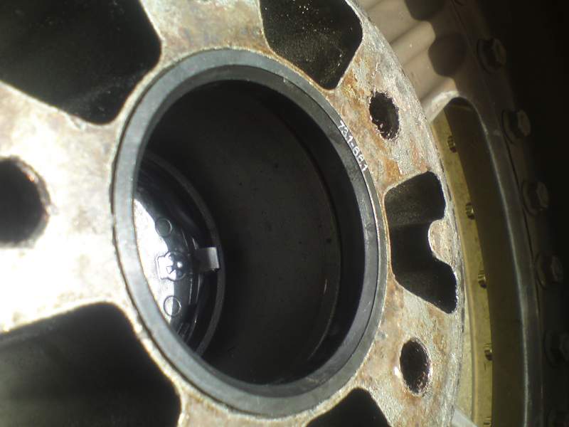

When I took my 25mm ones off I notice a spigot ring was cracked so I got a set of four delivered, inside diameter of 66.1mm with a wheel bore for my Work wheels of 73.1mm :cool3:.
My last and final update, spigot rings offered in and what a perfect fit :thumbup1:.

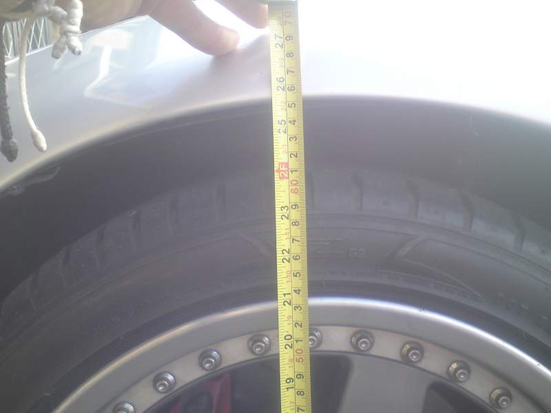

I will drop it Stephen as from this pic from the ground to the arch it's 650mm, on the rear this measurement is 630mm, so a near to 20mm drop is my remit and should look a million times better imo :).
