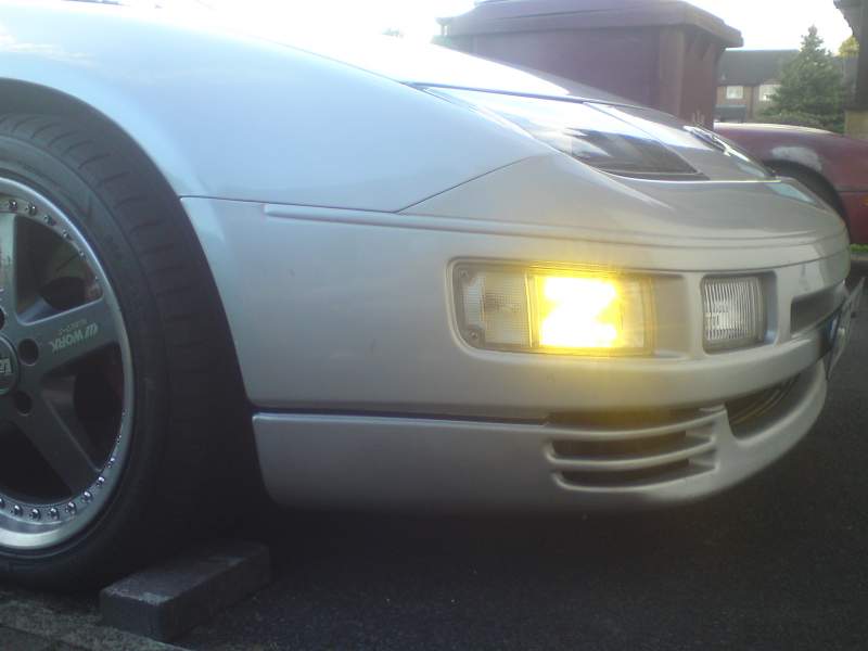

First time i noticed the front indicator illumination is in the shape of a Z :thumbup:
They are new Graham, did them a week before JAE and showed them off there, people don't really notice until you tell me them to stand back and specifically look.
As you know all my 8 indicators use the same smd yellow strips to match perfectly in every chamber and they're very bright.
Because previously I had the clear crystal units in the front corners I had to 'hide' the strips, so I wrapped just 3 around the base of the white bulb I had in there. I then acquired the ones you see with a more forgiving diffuser lens, so I fiddled around with regard placement and decided what the hell I'll see if a Z will work.
Done as a quick bit of fun really but I like them and I think they're well executed and for the time being are staying, they switchback with the white cree sidelight bulb I have in there but you expected that they would do that :wink:.
