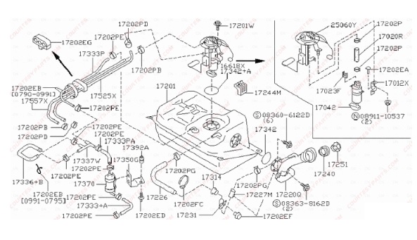

Hi Dan,
Thanks for the info - what parts are you referring to (see diagram).
Cheers
on that diagram it does not show the baffles. undo all the bolts holding the fuel pump in place remove the fuel pump when you look inside the tank you will see a plastic half tub you cant miss it its held in with 4 little tangs just bent up and its free need heating with the heat gun to get it throw the hole makes the plastic soft. that bit is ok but there is a other get your hand in the tank and have a feel round and you will feel it but cant see it this is after you have wash the tank out of coarse many time! thats held in with 2 tangs if i remember you have to work blind on that one, once you have a look you wil get what am saying , my tank smoked the whole powder coating place out as when backing it melted it and then stuck in side the tank spend like 2 hours cleaning the melted mess out

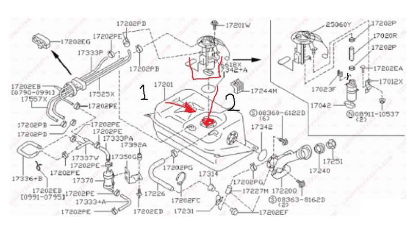

red arrow points the the breath baffle location but its inside the tank. and arrow 2 point to the loction of the basket in the tank i have drawn a crude pic round the fuel pump of what it would look like when the pump is in the tank as you can see it the bottom of the pump sits in it do you see what i mean ?tank.jpg
Oh ok, I get ya. I'll make sure I retrieve it all when I pull it out. I guess it can be reused if removed correctly?

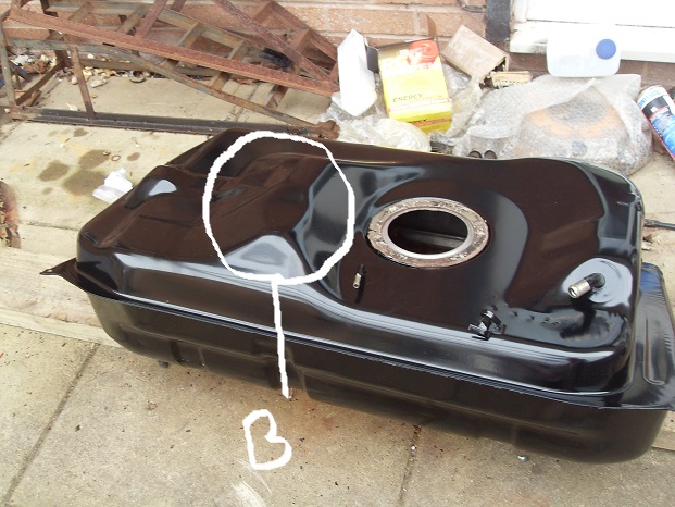

the tub that sits round the fuel pump yes can see reused just needs heating upa bit with heat gun to get it thro the fuel pump hole the breather baffle my melted so its gone now, look in pic see the hump i have draw a a while circle b stands for baffle. its in the there you can only feel it and cant see it if you dont get it out it will melt in the tank and make a rite mess and it **** to clean out SDC12392.JPG
