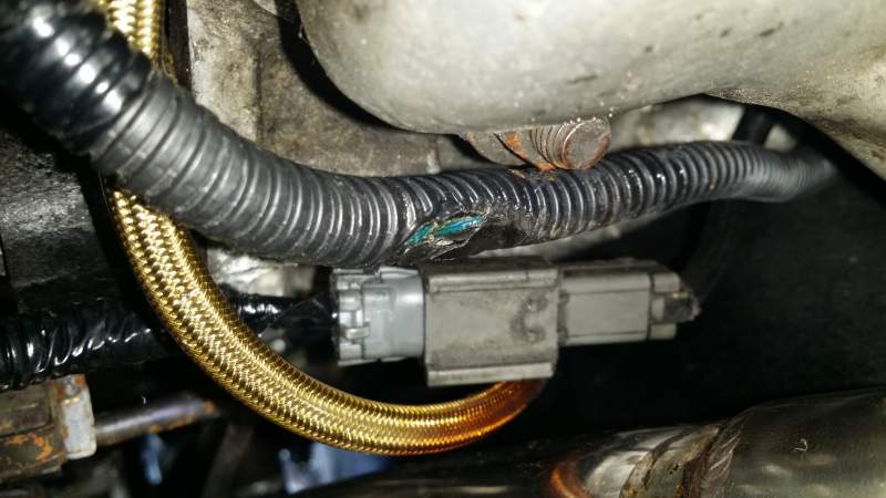

I did have a burnt loom so something could be blown but I cant find any fuses or relays.
Also when I bypass the gearbox loom and connect the cables near the left headlight its still dead.

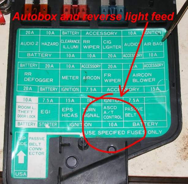

Yes it is weird to share the circuits that way? always was a quick check of mine when zeds had gear change issues or non working cruise control was to put it in reverse with ignition on but not running see if reverse lights came on, if they did not it was the same fuse for the box reverse lights and cruise.
Jeff
Jeff
Great info Jeff.:thumbup1:
Reverse switch is quite high up the box, be easier to ease the loom tails to the switch down a little snip it off and run a clean pair up to the connector behind the drivers headlight.
