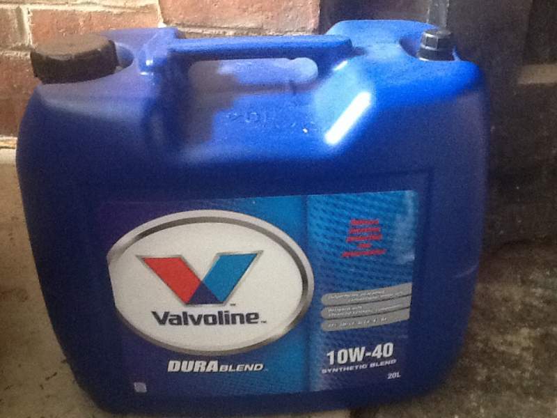

I bought 20L of this for under £30 from Eurocarparts
Good stuff read about it on Internet before u spend more on 4L then have to buy one more L!
I've got Valvoline in my Z. I usually use Comma oil which is very good.
