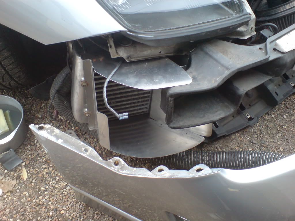

What intercoolers you got?
Godspeed with bumper modified for proper ducting.
