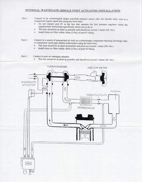

I'm going to replace the filter for the line that comes into the cabin for the Greddy boost controller and aftermarket gauge.
Would a fuel filter from a motorcycle do the job?
Do you have a filter on the line from the balance bar to boost solenoid in the bay as well?
I got a filter with my profec II and it was a small inline paper air filter the size of a 10p, sorry don't know about motorbike fuel filters
Yeah I've got one already it's just seen better days
Perfect, thanks Andrew
