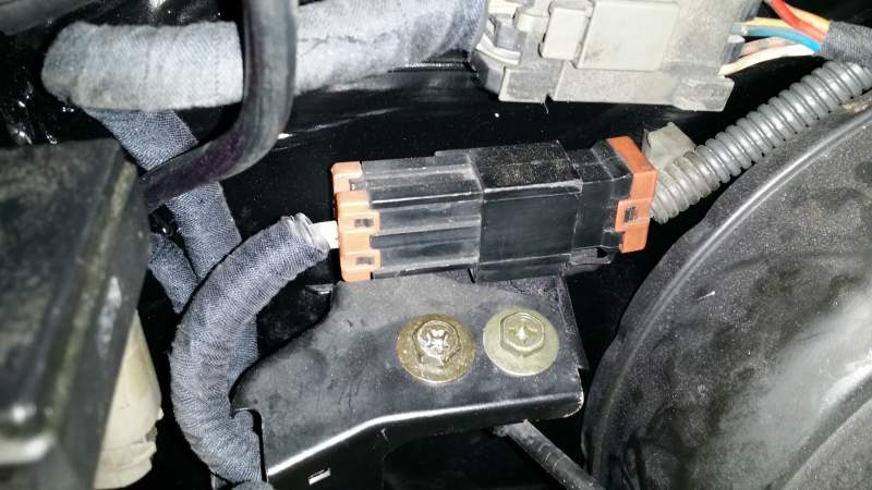

So got my new battery loom today but the old one has an extra lead coming off it.

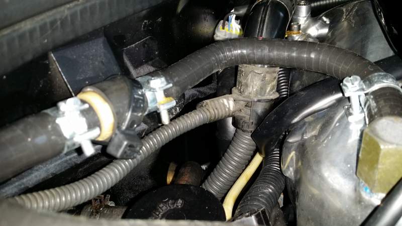

It seems to goto a connection behind the clutch vacuum piping, my zed is a tt manual but was
an auto so is this extra cable for an auto box ?
Also the new loom has both positive and negative combined in one but the old is actually two separate cables.
If I'm not mistaken that's the positive feed for the internal fuse box in the driver's footwell.
On the rhd loom you have a combined loom, one going to the starter then the other wire which powers everything else that plugs in to the power distribution box
On the ltd loom I think they are separate
