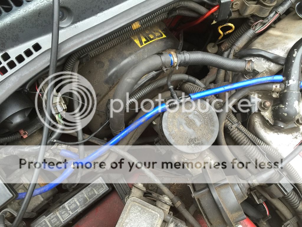

Putting some pictures up might help. It would be really really flat at 3psi so you'd know if it was that low. Both turbos produce 9+ psi you're bot getting half a reading.
Have you got a leak between the bar and the new gauge? Is the pipework too large? Have you teated the aftermarket boost gauge? What brand is it?
Hope some of this helps.
its a brand new TIM
you can see from the pic were its teed

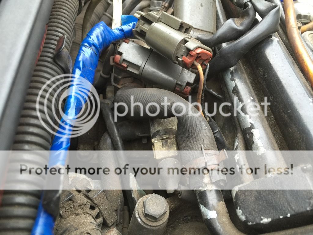

It's a mechanical gauge isn't it, so that line going up in the pic goes into the cabin. It could be pinched or whatever.
Nothing looks wrong to me if they are all securely on their fittings.
Probably time for plan 2 ^^^
On second inspection, look at the electrical connector next to it! Get it all refreshed mate :thumbup1: :clover:
