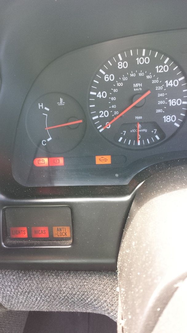

Side note, 2 (i think only 2) of the warning lights on the dash aren't illuminating. I believe they're supposed to be the seat belt, and door open lights. (see below)

when I first switch the car to ON, the "POWER" light flashes for a few seconds, then goes out. This normal?
Not normal, it's the car telling you there are stored error codes.
