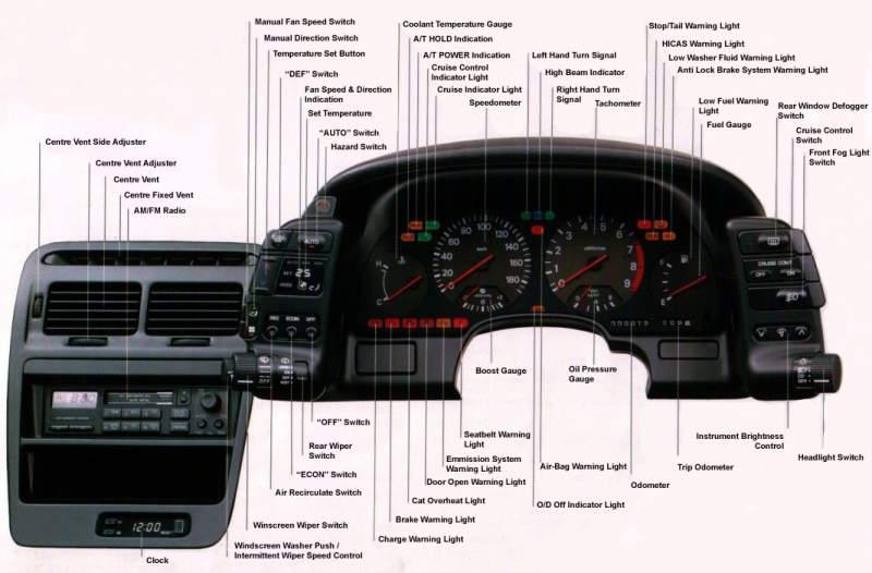

Got it home tonight and been going over her. Found some issues. The first being the boost gauge on the dash isn't reading anything. Just sits in the centre on the 0 line.
Next I switch on the headlights to find firstly that the dash doesn't light up, secondly that the sidelights come on (round ones) but not the headlights themselves (rectangle ones) now I do eat my carrots but i can see this being a little dim at night.
Has anyone any idea what this could be. Forgot to mention that the rectangle lights work when put on main beam but not dipped.
Also, under the dash light panel on the right of the column, where the power light comes on when gearbox set to power. There is what looks like an aftermarket rocker switch. It illuminates when the headlights are on but when switched doesn't seem to do anything??

The boost gauge reading 0 will be to do with the boost sensor, in the engine bay right up in the drivers corner. Follow the vac lines from the balance bar to a small black box, will be either faulty or hose split/snapped underneath the box. Round lights are the dipped beam. Rectangle lights are full beam only. Rocker switch will probably be rear fog light.

The dash dimmer on this car appears to be a two press switches on the right of the wheel cluster where the headlight switches are. I've pressed the switch up amd down lots of times and nothing is happening. I've covered the gauges to shield them from the outside light but still nothing.. I was told that a previous owner had installed L.E.D lighting for the dash nut no evidence of any kind of illumination at all when I'm switching the lights on.
I just bought a new switch cluster thinking it could be a faulty headlight switch, but i guess that's going in the sparea bucket for now! Lol..
So any ideas on where to start checking next?

Remove the drivers light pod, 3 screws under the pod housing and check the bulbs in the rear, 4 green bulb holders oem and 1x black in the rear of the light switch.
There is a possibilty if the dimmer isnt working that the TCU is fubarred, its a fag pack sized opaque box behind the kick panel next to the fuse board, you need to remove the entire plastic panel from accelerator to the door edge and its situated near the bottom along with the fuel pump relay(green)
The TCU controls among other things like intermittent wiper speed, the dash lights.
Rocker as said above rear fog light, aftermarket so might have been removed after MOT, check for wires under the rear bumper, or the drivers reverse light may have been converted to a fog light.
Standard headlights are generally pretty poor and likely need a clean inside the housing and the projector lens itself, most of us upgrade to H3 HIDs, which make a world of difference

Also can you clarify the drivers light pod? Are we talking about the pod with the headlight switch in it?
If the lights that backlash the clocks etc aren't working too, would this indicate the TCU? Or could it be a faulty dimmer causing it all?
They grey plug hanging down near the bonnet release is the diagnostic port, HID are plug and play get the 5-6k and you wont get the blue look. The two wires from the ballast connect to the lamp plug and the HID lamp from the ballast into the lamp socket, then you will need to look at either earthing out one side to stop the HIDs going off when you flash the mainbeams or dong the proper solution, which can be found in the tech faq section under electrical.
Driver pod with the switch yes, the dimmer switch itself is unlikely to be faulty, but the TCU is responsible for the dimming.
There can be burnt tracks on the board which cause issue with the lighting, i had a track burnt out on mine once and lost all dash lights/pod lights, so TCU out to check.
