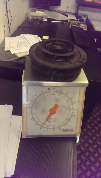

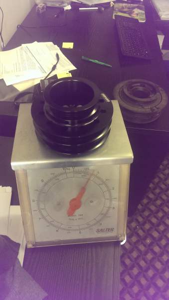

In total, more than 15 kg was taken off of the drivtrain weight
The original crankshaft pulley weighed 6kg and the underdrive pulley weighs just 700g

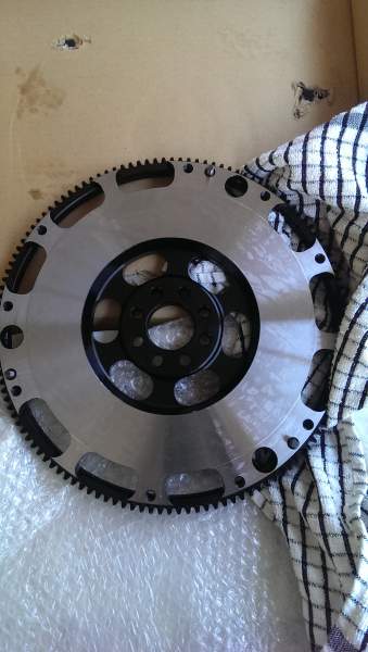

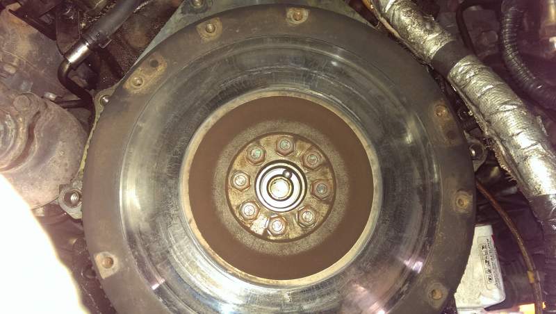

The original flywheel weighed 10kg, the CC ultra light weight unit weighs just 5kg

Here's a few pictures showing old and new! See the surface cracks on the flywheel surface too!
