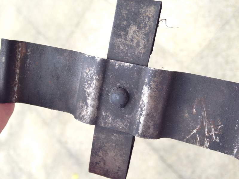

Before I refit my refurbished Brembos, I want to clean up the brake pad rods, clips and springs as I don't think cleanliness were the concern of the brakes' last owner!! They're heavily coated in baked on carbon. Autosol removes a little, but I was wondering if there was a solution for dissolving it away.

ive cleaned them many times Simon...there stainless steel and come up a treat with a brillo pad in soapy water;)
If it really is carbon on there - caustic soda. Don't use it on anything aluminium !
Its not carbon..its brake pad material ,same stuff that you find a b1tch to remove from your wheels
