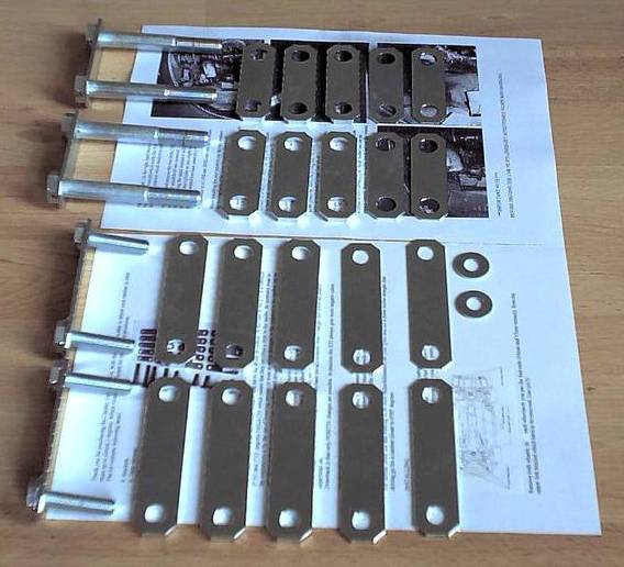

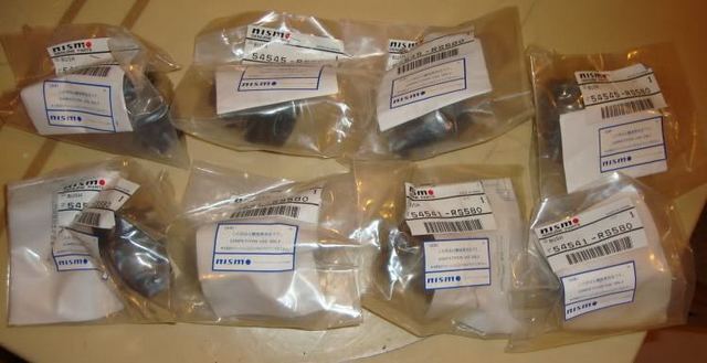

FYI - I'm using the Frank de Ruiter Camber Correction Kit (no longer available) with FUCA's rebushed with
Nismo bushes. The CC kit came with instructions which gave the various shim thicknesses required to achieve
different camber degrees (so could be copied). The setup is fit and forget and tough and near to stock ride.
