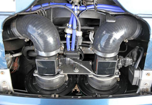

Never had that problem with mine (now two for the dual maf setup), but then I have them mounted as high
as possible behind the '89 spec bumper and the upper slot in the bumper is covered by the number plate.
Most importantly, I follow the replacement regime. The filters are the dry type (don't oil). HKS state replace
every 6 months or 6K miles. I do mine every 12 months as I do less that 3k per year.

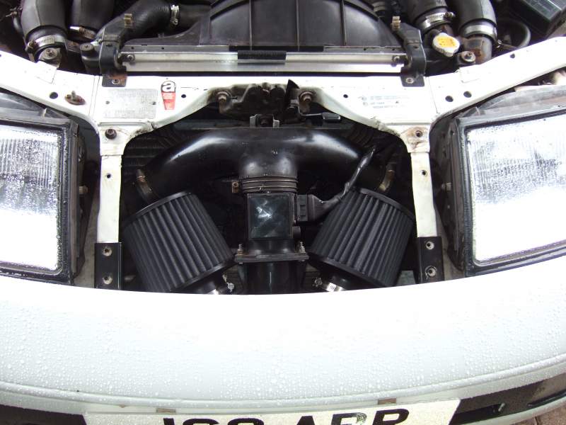

I've got a JWT pop charger on my white zed. Very good and has a washable element I use the K&N cleaner and oiling spray on it it work a treat. Replacement elements are cheap enough too.
I have a large K&N cone filter which seems ok. I've only cleaned it once with the K&N cleaning kit but no issues so far..
Me too.:yes:
Outshines the Apexi any day. One of the largest and highest quality filters known to man.
Lovely large radius inside on the ally cone too.
