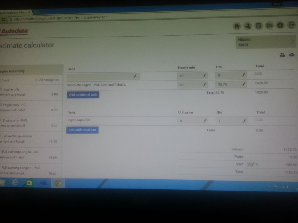

ouch just looking on autodata seen how much to remove and rebuild an engine,
You do realise autodata times are based on jobs not considering seized bolts,stubborn pipes etc etc and prb 3 workers on 1 job
so all the work is done from the top side. if the box is of can you do all the work from the bottom side
yep sometimes i do jobs much quicker sometimes i think how the hell lol, but i use it for rough pricing of jobs on cars i dont know well, never really looked at zeds on it, but some labour times would be scary the prices it would work out too...that job showing on screen is nearly 2k without buying a bloody part lol...
