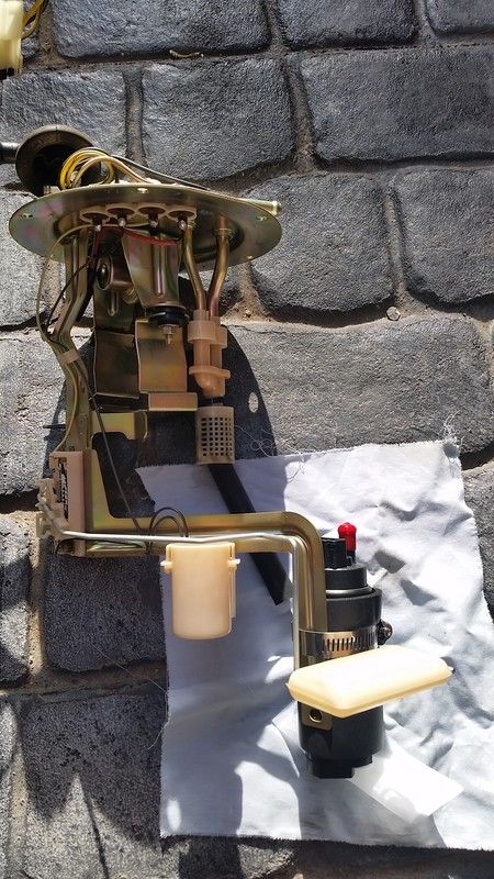

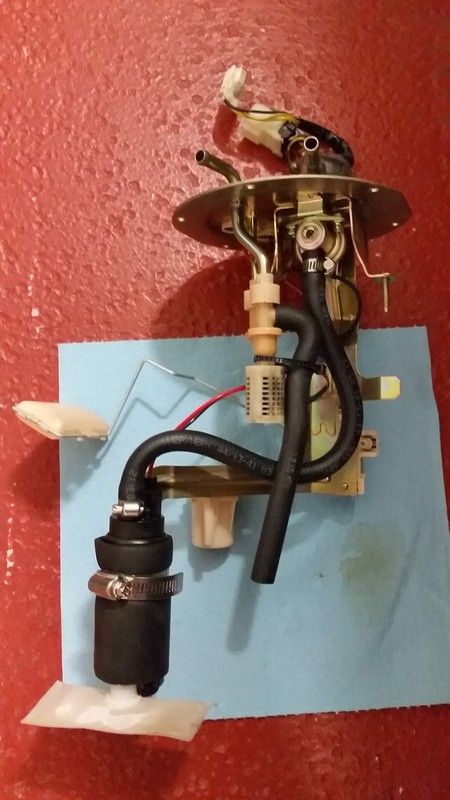

Just thought id stick this up for those upgrading the fuel pump and own a SWB. Saves you taking it apart and then realising you need extra bits.
I needed to buy some in tank fuel hose as the one supplied was not long enough as it is for the LWB Zed. Make sure its R10 stuff and ok for in tank use.
Heres some pics of how i installed it.
Note i had to wire to existing loom as wiring was also too short to go to the top connectors.
Good job Paul,submersible fuel line is essential as you say,expensive stuff compared with regular stuff
