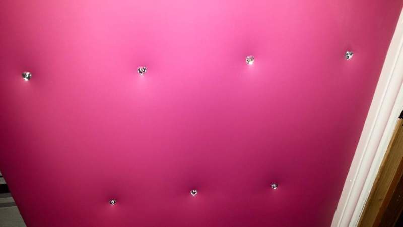

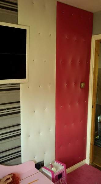

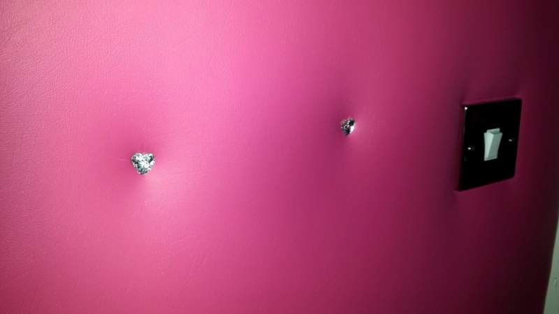

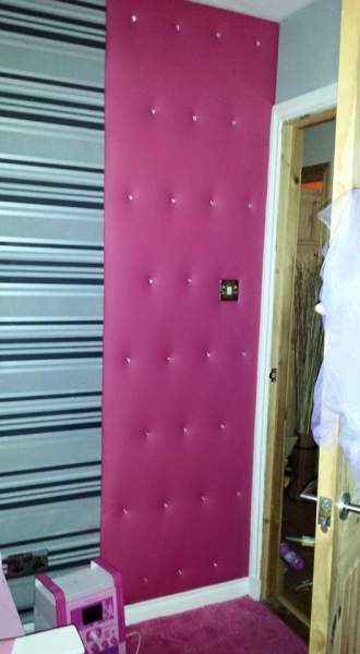

Been doing up my wee girls bedroom recently as she has moved into our old room. since it had wallpaper on a plasterboard wall that would be a pain to strip off decided to give her a leather wall. takes more time than I thought lol but its getting there. These are easy panels so fair play in the work mondo does.

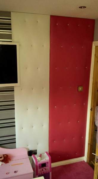

cheers. my wee girls loves it. iv done one more panel from those pics but have ran out of padding so just waiting on more coming then il get it finished off

that looks awesome mate is that just faux leather wrapped on mdf panels and stapled or glued My niece would be in to that maybe you can start a side biz ;)
yeah its sheets of mdf cut to size. stick some either foam or I doubled up some thick wadding to the board then faux leather over the top stapled rounf the back. the little lve hearts go on like a button so used a pointy screwdriver thing cant remember the actual name to push through the leather and mdf then staple the thread on the back securing the button on. not that hard to do just time consuming.
