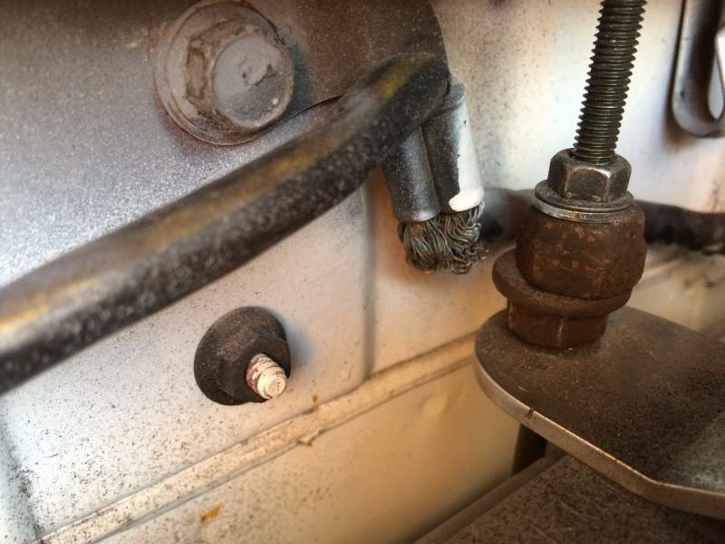

Thanks guys, give me something to look into tonight. I've got an auto electrician coming round tomorrow. The only obvious thing I can see is a dodgy earth connection.

Cars just been given a clean bill of health so turns out its the battery. Only had it for 7months & it's not holding a charge, taking it back to halfords but got no receipt so don't know if they'll change it.
