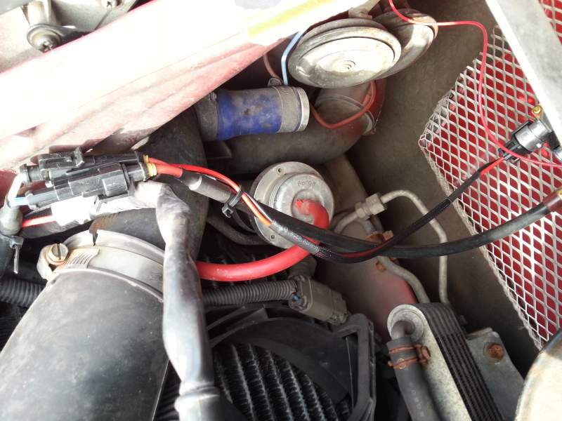

do or can we run without recurculation valve things?
As you can see in the pic i think the recurulation things have been deleated so to make way for the bovs.my question is when i make up my own pipework to my fmic the bovs will go aswell.do i need someform of recurculation going on or can i just run without for a while
. i think cas i eventally want a nice set right up in front of the throttle bodies.
