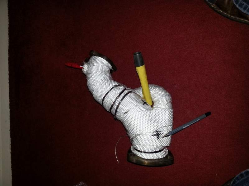

I fitted mine last week, take my advice , get the kit FIRST, then get under the car and decide where to place it , as you have been told 10 degrees above horizontal, perpendicular to the flow, you will find that with the sensor in your hand and the guidance of angle and distance that there are only 1 or 2 places it can go, Mine is fitted at the rear of the AUTO box cross member and the electrics passed into the cabin via the original CAT sensor bung, my Wide Band used an 18mm bung, but like I said do not try and fit anything up until you can decide on position exactly by getting under the car.

Spin see my thread "Powerzed engine rebuild" as I have some more info for you regarding positioning widebands
Cheers Howard.
