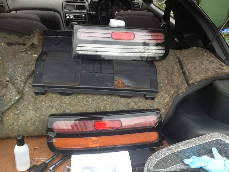

Note: when using it, stretch it and roll it. If you lay it on as it comes off the reel, it won't compress enough for the lights to fit snugly and you'll end up pulling the studs out or inverting the nuts.

You need to do the same with the OEM Nissan reel to an extent. MJP can get you the original stuff, I can't remember the price for it though, I think it was close to £25 from memory.

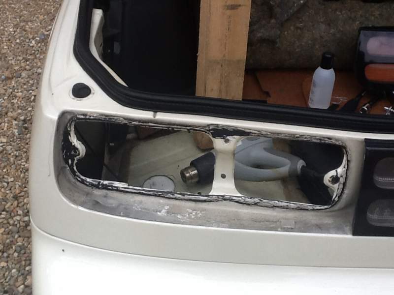

I did mine last year! It was not silicone cos I had to use a heat gun to release them!

...send some to Veilside for a trial.......be careful if you need a heatgun to get it off!

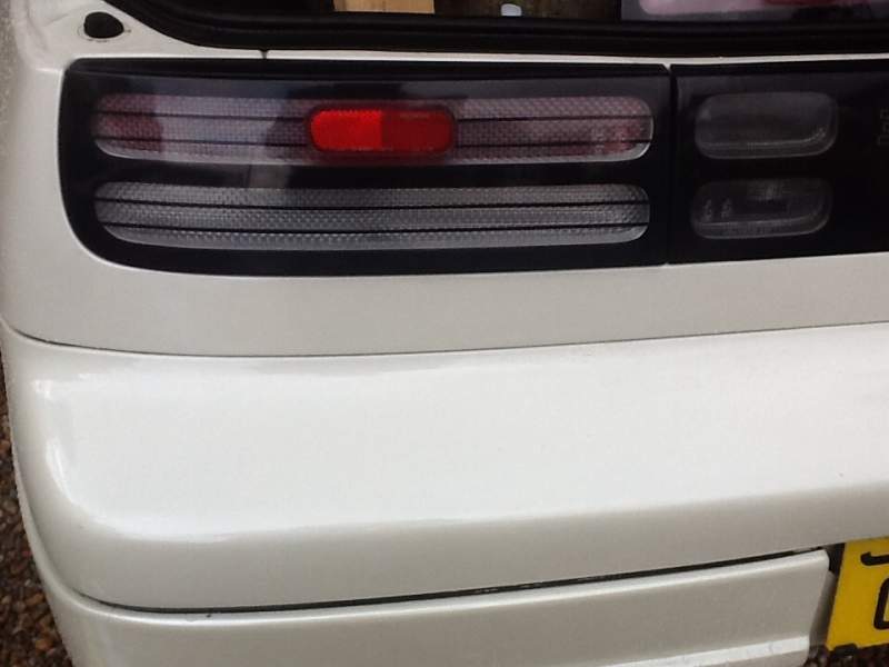

Works fine, compared to OEM sealant easier to fix lights in place and when removing them. Doesn't damage the plastic
of the lights and puts much less strain on the fixing studs as the units are mounted in place.
I also have two unused rolls of OEM sealant that came with the '99 specs that you can have for £15 all in.
