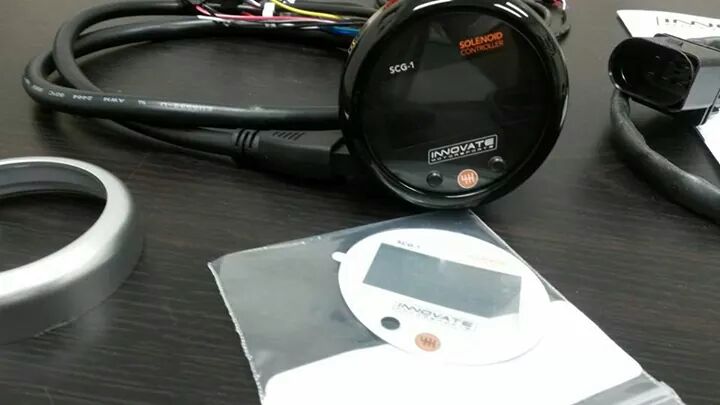

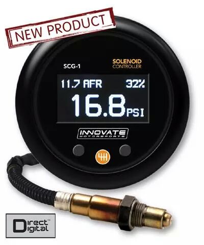

have a look.see what you think.
like this idea. The conbination of a wide band sensor and a boost control all rolled into one little neat gadge.heres an explanation on youtube.
and for about the same price as a wide band monitor or a boost controler.feels like you getting one for free.and less clutter in your car.views please.could well be my next purchase.
And, as i understand it . If your car runs lean it will pull back the boost back to spring pressure.so not only does it tell you.it also saves your engine from going bang.

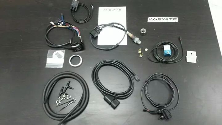

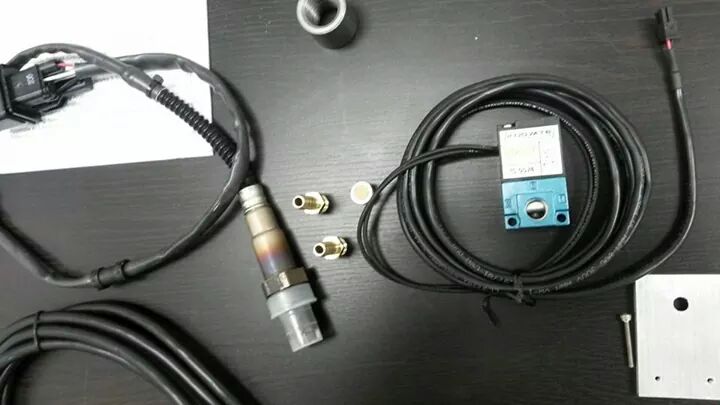

U dont need two ebc.so ehat your saying is you need two wife band sensor things.but there is bungs in the kit so maybe they get relocated.have to look into this.
Single outlet exhaust will require just one wideband sensor, but that obviously won't measure any discrepancies between the two banks.

and will need locating further back after the flow combines as a result
