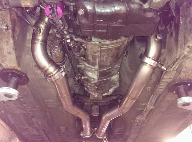

[ATTACH=CONFIG]84905[/ATTACH]
Those V bands [emoji7] I'm surprised more exhaust systems don't use them.
They're on loan from Jaffa, helped me through TOTB last year they did!
I've got to give them up soon, so I will be back to regular flange.
Oh, I've got plenty of V-Bands, but I definitely wouldn't consider cutting & shutting an exhaust just to make it V-band!
