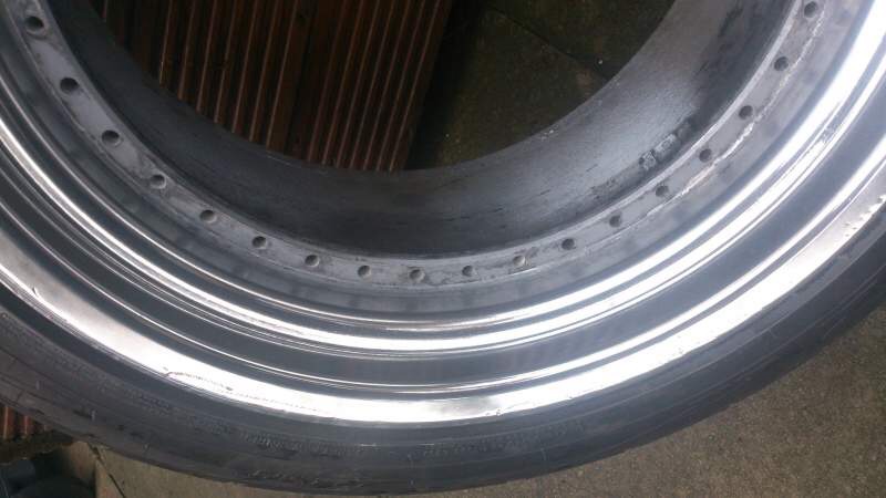

Are yours 2 or 3 piece wheels? Looks like they're 2-piece? If they are, they won't need any form of seal. My last set of split-rim wheels I had done by a chap in Nottingham who did an incredible job!
I'm not sure Si. I thought they were 2 but looking online I've seen a few people mention they're 3 piece. I'll keep you posted on how it goes Trev, hopefully the hardest bit is taking them apart.
Easiest way to tell mate; when you undid all the bolts, were you left with a wheel face and a barrel or a wheel face, an inner and an outer barrel? Some 2-peice barrels are seam welded to create a single. Go and have a look.
Actually, looking at the wheel, I see you still have the tyre mounted! Good job they were 2-piece or 2-piece welded else that tyre would be as flat as a pancake.
Would have thought if they are 3 piece the tyre would of deflated when you unbolted them.

Those wheels are 2 piece. The barrels would have popped off and hit you in the face if they'd been true 3-piece!!!

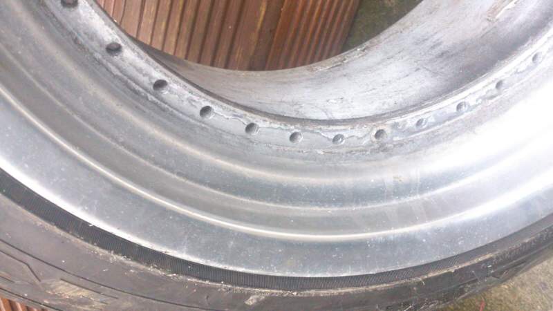

Looking at the pics, look like 3 piece as you can see the front and rear rim join.
In that case, they must be well stuck together and you have been very lucky they have not burst apart under pressure, as Si mentioned, if you haven't deflated them before you took the center out?
Nope three piece :p
They wouldn't be!! The barrels with no fasteners on would not hold the tyre at pressure. If they are described as 3-piece they are probably welded 3-piece as I described above. :)
Maybe mate. Tom will soon find out when he starts work on them.:yes:
If they were originally forged as a 3-piece set, then the outer and inner barrels would definitely have been welded like this effectively turning them into 2-piece wheels. If they were true 3-piece construction, that tyre would not be where it is in the photo. :)

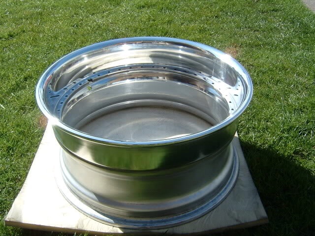

This is the barrel from one of my old Advan Siena wheels.
