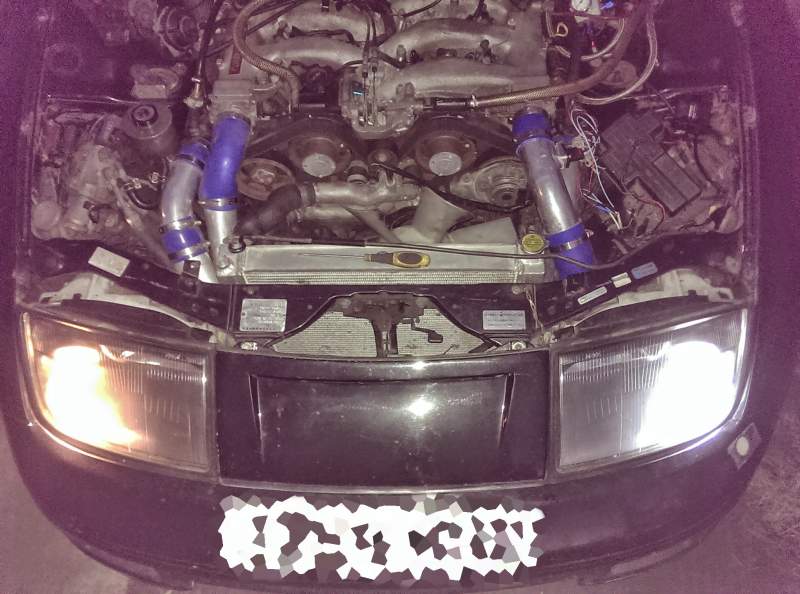

Blow-Through MAF: Something I'm working on at present :laugh:
What's needed: A slot-style MAF with accompanying 9th order polynomial function, a TIG welder, a soldering iron, an AFR gauge, a dyno, lots of mapping and lots of modification of ECU parameters to get it running spot-on.
Can make it out in this comparison pic of the new HIDs fitted (it's not been hard-wired yet):
I've also run a standard MAF in blow-through configuration, it required a lot of modification to the OEM VQ map.
